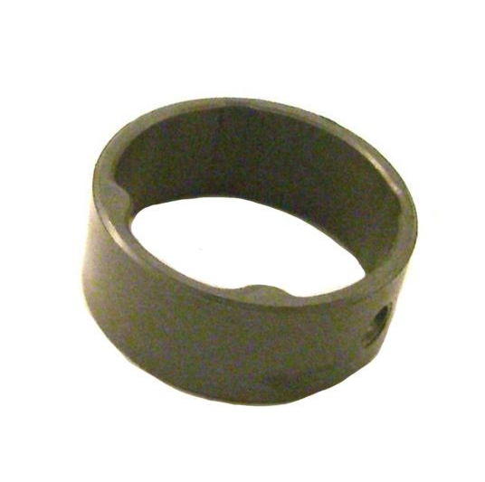

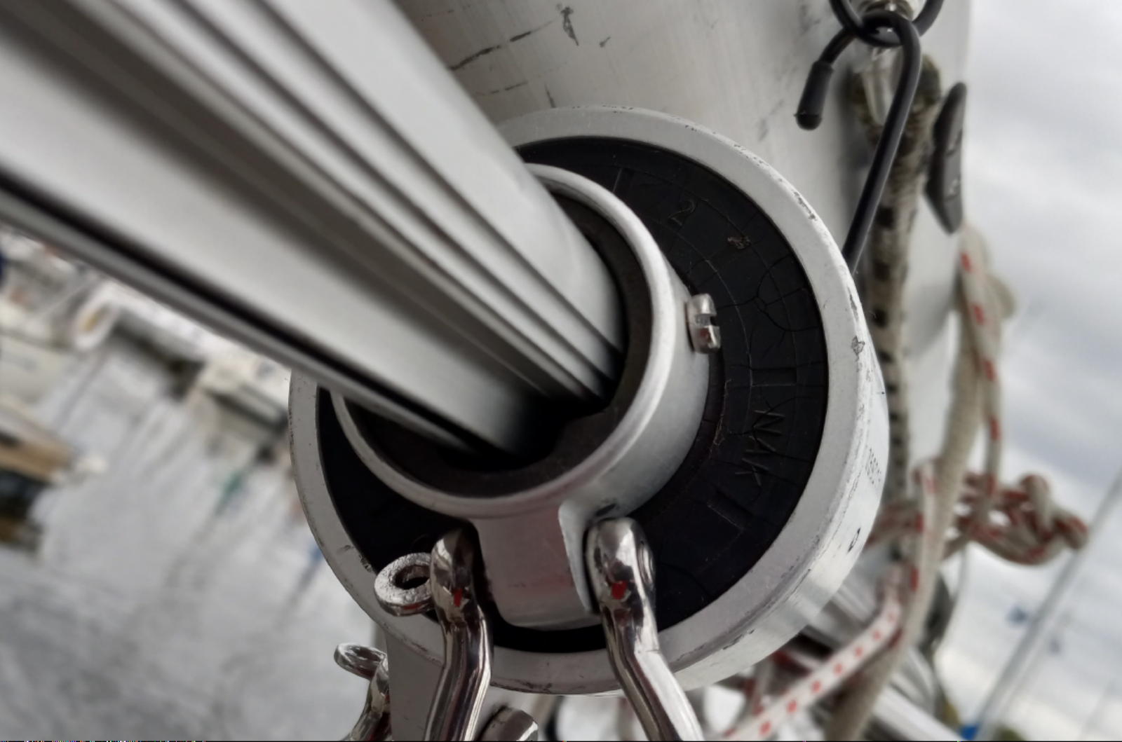

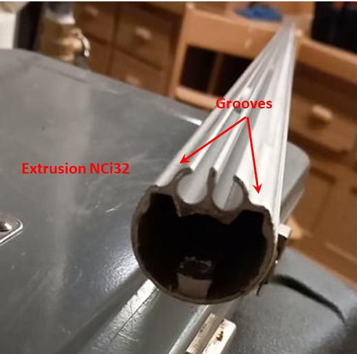

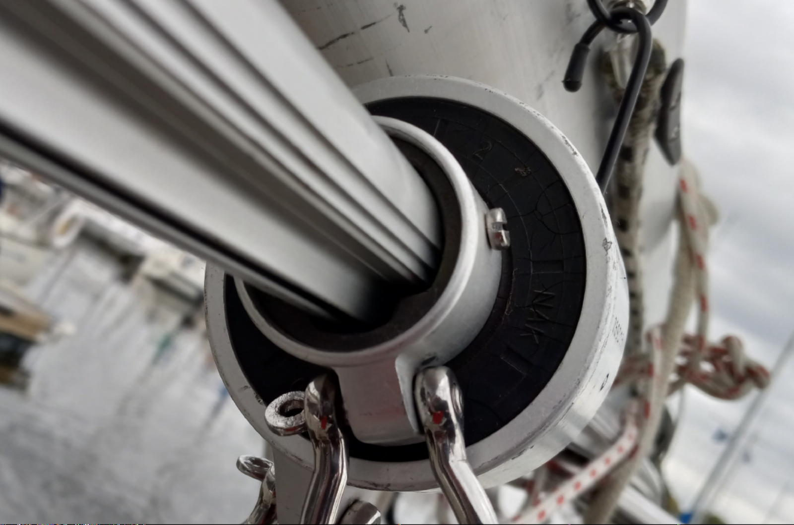

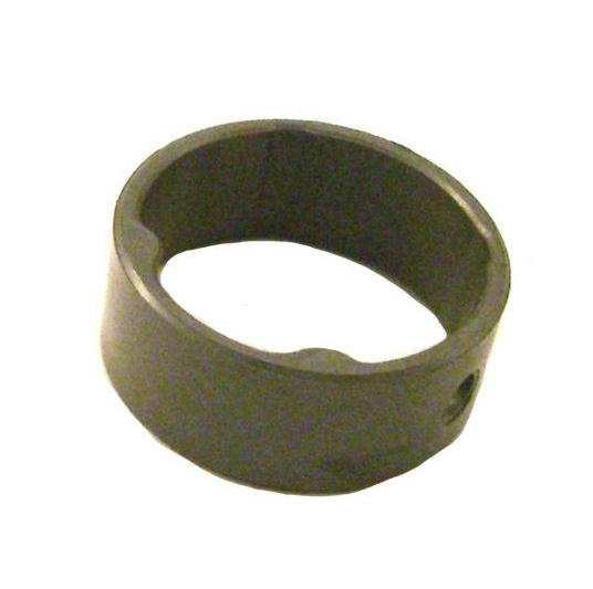

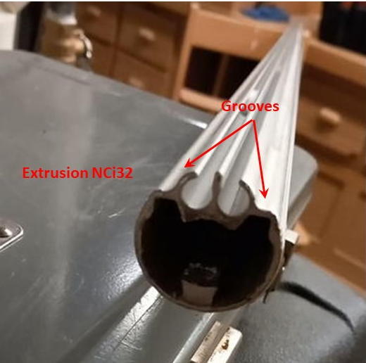

In my case (Profurl NC32), it was the bushing inside the swivel head that had turned and locked itself on the extrusion. The 2 little protrusions inside the bushing had worn out, getting out of the grooves in the extrusions and allowing the swivel body to turn on the extrusion itself, locking right at the gap in-between the top 2 extrusions. I had to get hoisted up, release the shackle of the halyard and get the sail down. It was at the end of the season and I unstep the mast before winter lay-up so with the mast down, I undid the headstay at the top, removed the swivel and ordered another bushing which I then press-fitted in the swivel. Incidentally, the new bushing did not have the 2 little notches and the Profurl rep told me there had been a change of design because of that locking on the extrusion issue. Once I had the part, since I already had the mast down, it was an easy job as I did not have to remove the furler from the boat, just detach the headstay top part from the mast, remove swivel, install new bushing, re-install swivel on furler and re-attach furler (and headstay). Took all of 20 minutes. Attaching pictures to help you visualize it.
