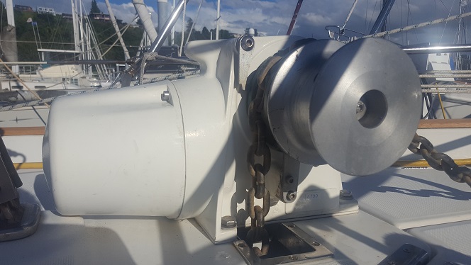

Can you identify this Windlass?
JonF
Jul 11, 2018
2
Beneteau 40cc Seattle

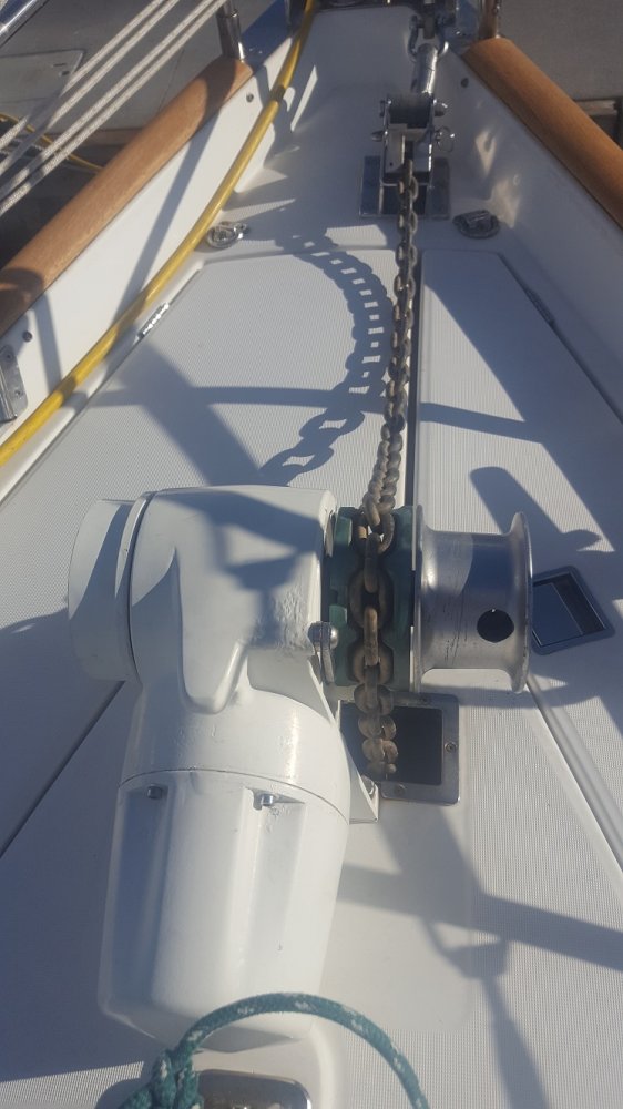

There is no obvious markings on this heavy-duty Windlass mounted on my 1998 Beneteau 40cc sailboat. Can you help me identify it?
- It is painted white, with no manufacturer's nameplate or imprint, only the #6790.
- It is not an Ideal or Lofrans, per their reps.Windlass right side_small.jpg Windlass top view_small.jpg
- It may have been mounted in the US or Canada if not original.
capta
Jun 4, 2009
5,100
The drum kinda looks like something made by Goiot, a French boat parts supplier. I don't even know if they make windlasses, but they do (did) make winches.
JonF
Jul 11, 2018
2
Thank you for the help - I did identify it as a Leroy Somer made, discontinued by Beneteau and no longer available. Hmm, try and diagnose why the manual release is frozen or discard and buy a Lewmar?
