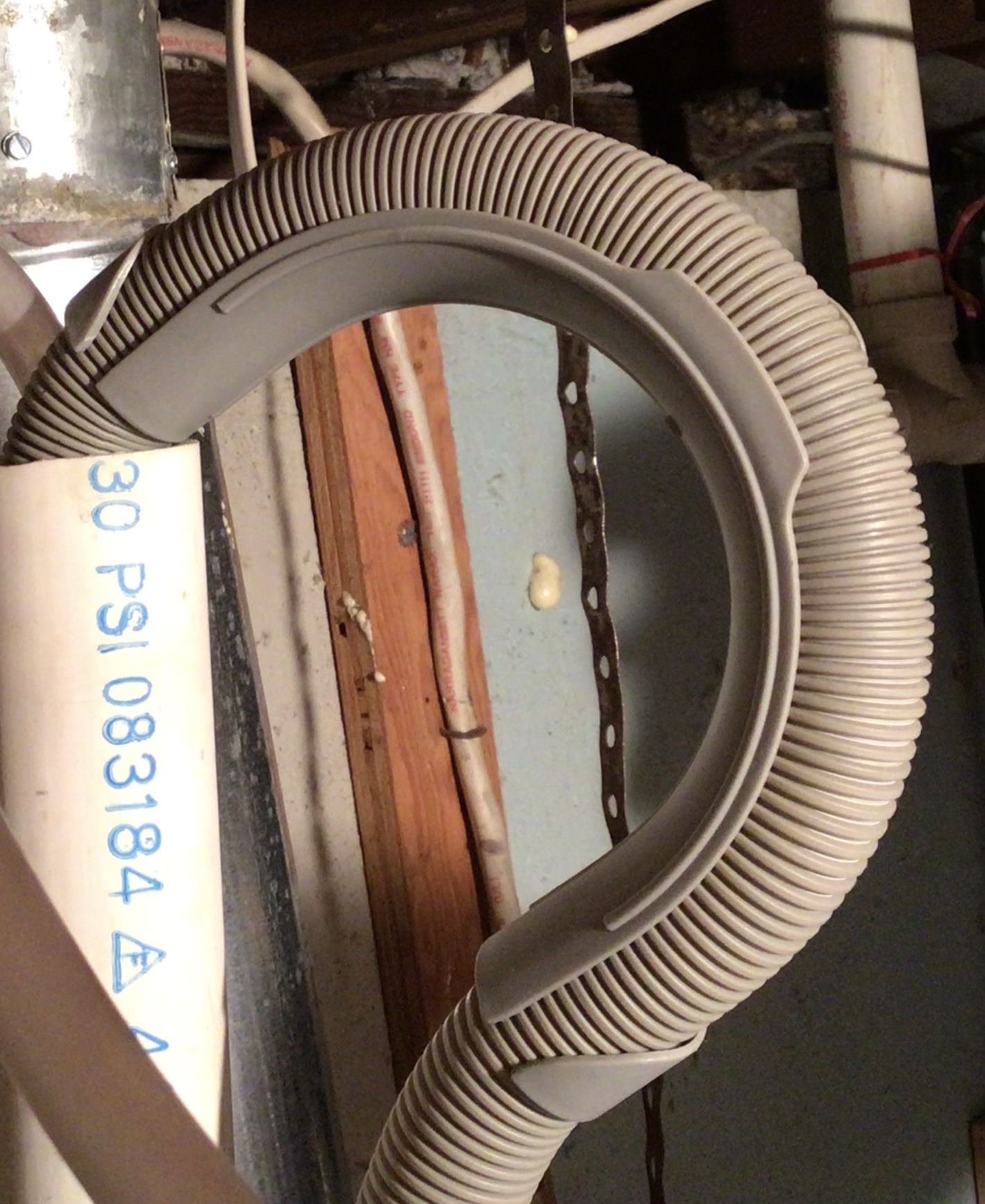

Pulled some panels off to do some AC work and found that the manual bilge pump drain hose was really kinked at the top!!! (See pic)
Any suggestions on how to unkink or remove the collapse? I tried straightening it but the collapsed section remained. Don’t want to replace the entire hose or splice a new hose in. Once unkinked I have a IlU-shaped guide to give it a gradual bend

Sure. But you may no be happy. Plastic once kinked has the memory of being kinked. Hose is not that expensive.
If you use reinforced hose it will not kink.
10,164
You could try straightening it then squish in the pooked out sides and very carefully apply some heat from a heat gun. just a random thought..
Sorry, I know it's not what you want to hear, but I recommend to replace it or splice with a male to male barbed 90-degree elbow fitting. If you do the latter, you might end up with (one or two) new kinks where the barbs terminate, but the angled fitting will reduce the likelihood of a kink. It will also slightly reduce flow. I'd replace it with a different type of (reinforced) hose that isn't as likely to collapse.

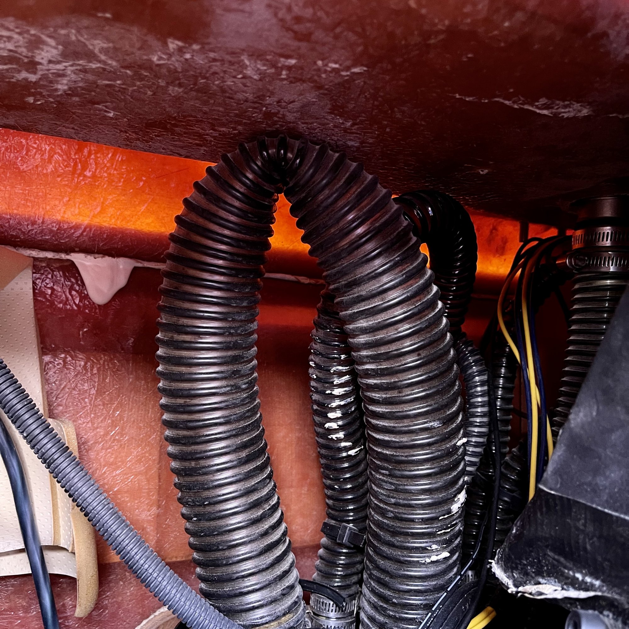

edited PS - I recommend you replace all of those hoses in your picture, unless they are 100% above waterline (even when heeled). Those look to me like they're a weak design and will likely fail at the spaces between the ribs. A different, reinforced type would be better.

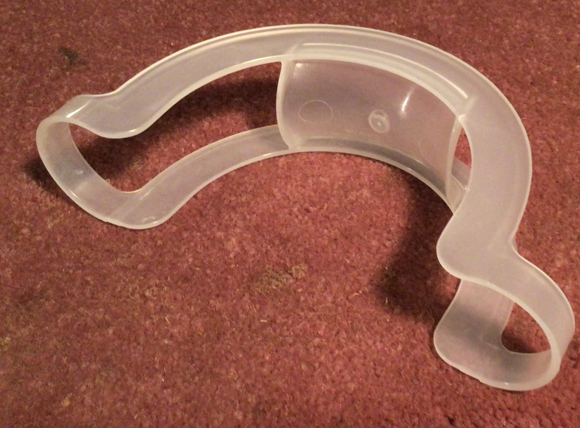

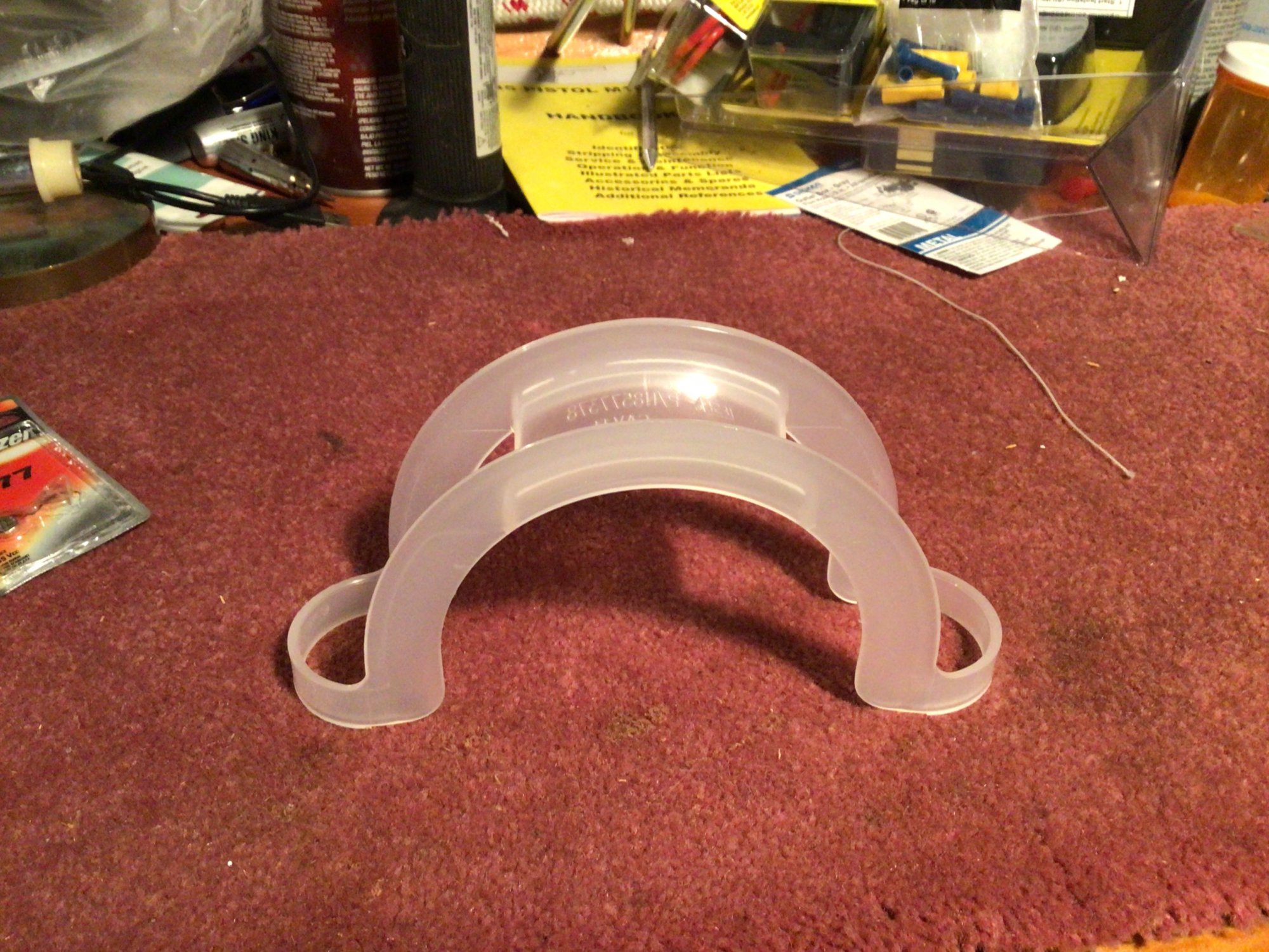

Can you get a washing machining hose plastic bend shaper in that area? They come with washing machines when you buy them, never wear out and hold the hose from collapsing when making that high rise to the drain pipe.
I don’t know why but I have 3 of these things and I’m betting a couple are at least 10 - 15 years old but still will work.
Hardware stores will sell them as a kit.
Look for the one with the sides split so you can slide the hose into it or you’ll have to cut the sides to do the same thing. This way you won‘t have to remove the whole hose to slide it over. Try it.

Oh those look better than the one I got!
