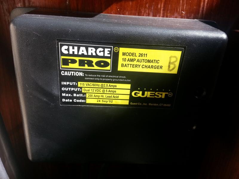

My house batteries are 3 batteries connected together and the charger and alternator appears to keep them charged good. I have 2 chargers one for house and one for the engine battery. The are just alike (guest) see photo.
