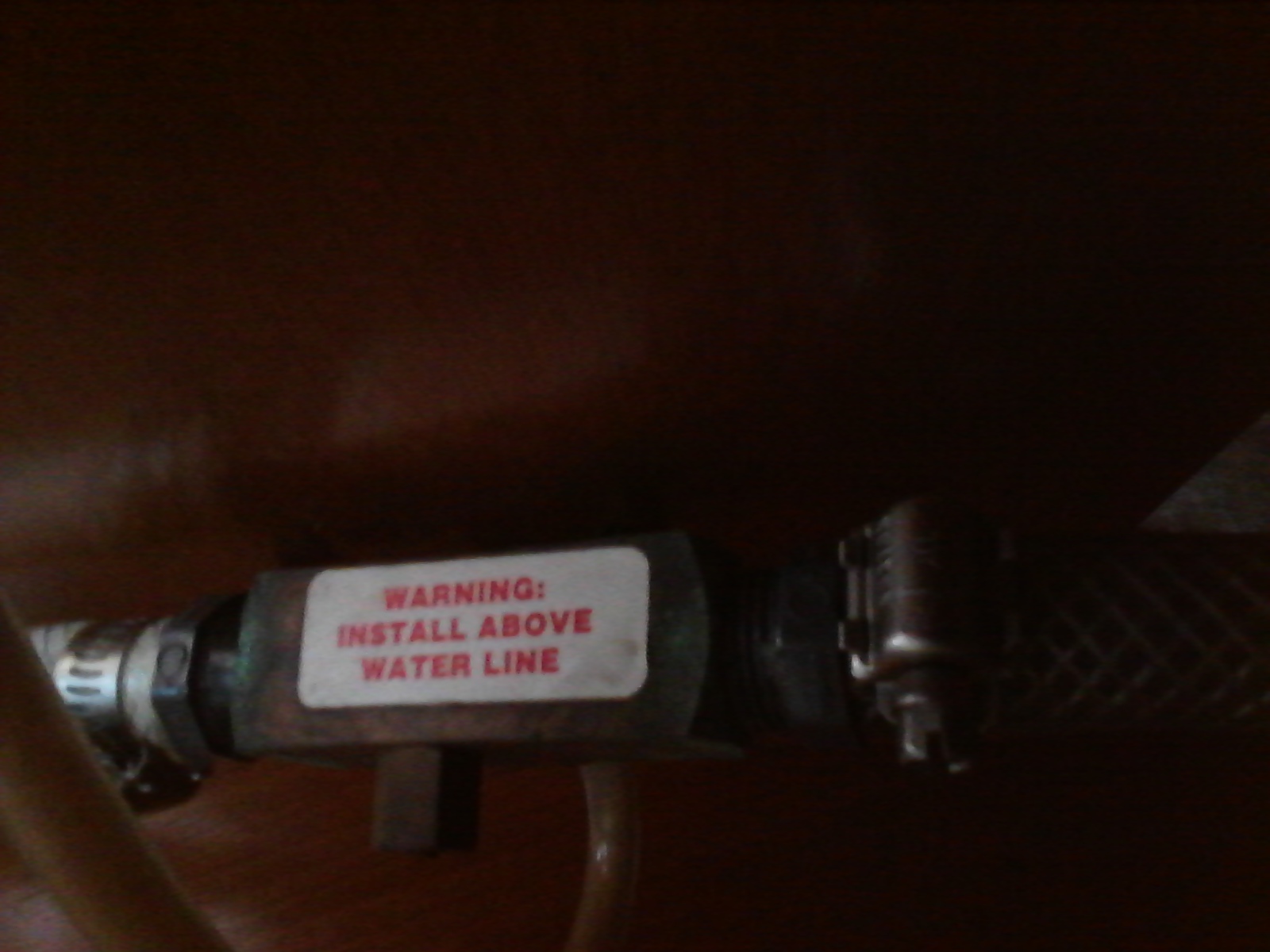

Can anyone identify this fitting?

I am installing a new air conditioner and removing the old one. The attached pictures are of a fitting in the line taking water out of the conditioner and running to a overboard drain port. The large line is the water out and the smaller line is from the condensation collection pan. Is this some type of syphon for draining the condensation pan?

Hey Solitude,
That is a condensation. It connects the pan to the a/c water discharge line. It keeps condensate from flowing into your bilge. Google Mermaid Condensator and it should give you a schematic for connection and parts.
