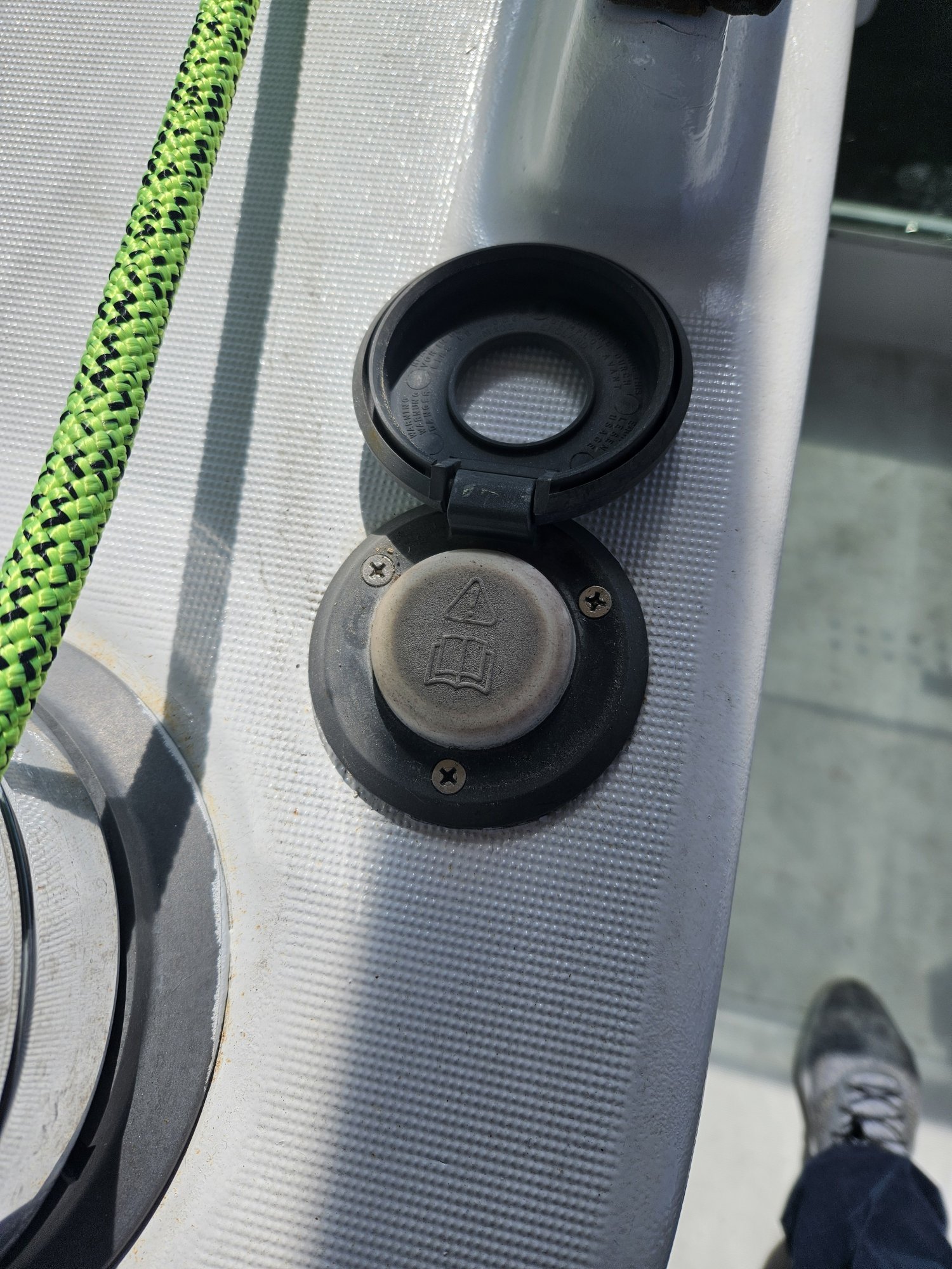

Can anyone ID this item on my 2000 Beneteau Oceanis 46.1?

Thanks, TOTALLY lost on this one......for $h!ts and Giggles I've tried it, w/ no reaction.....

Hmmmm.... it is only on the port side of the cockpit, and it doesn't seem to operate anything "as we speak". I just purchased the vessel, and will have to research some operation directions, if indeed it is a winch switch. Thnx for the quick responses :)

There might be a circuit breaker for the winch that needs to be switched somewhere. I wonder if Beneteau might have put that near the main battery switches. That’s where the breaker for our windlass is.

It looks like a Guard Top - single-function switch. Since it is located in proximity to the Winch, it would be my SWAG that it is for the winch.
As it is on the deck, there should be a breaker for the winch located in the cabin to power it. If you switch on the breaker with DC power and it still does not cause anything to function, then you will need to explore the DC Power availability, the wiring, and connections for the winch and the switch.
Surveyor didn’t identify a non-working electric winch?

Just liability as we speak, while I update/outfit her.... that'll come later for full coverage

As was said it is a switch for the winch next to it. There is a seperate breaker for it.
