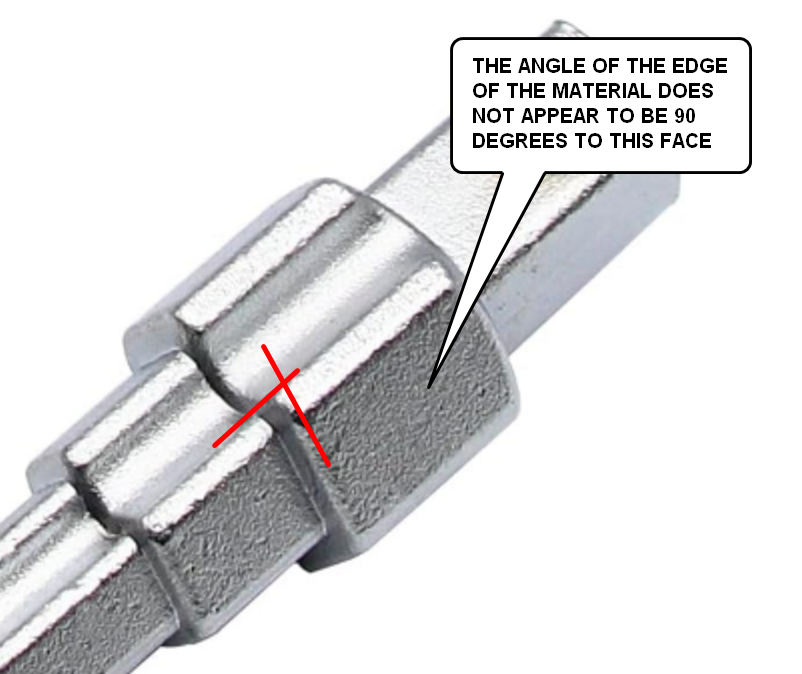

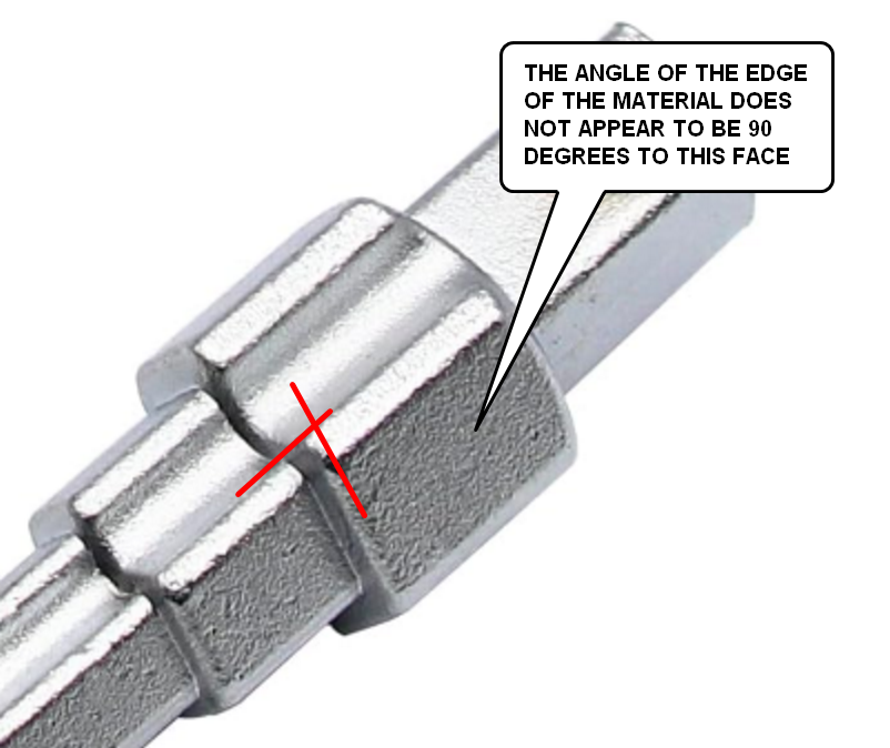

Can a plumbing step wrench such as the one below be used for a through hull? This one is $10. At that price, it wouldn't be worth making one out of a pipe
Step Sizes: 10 | 11 | 12.5 | 16 | 21mm, 3/8" 7/16" 1/2" 5/8" 13/16"

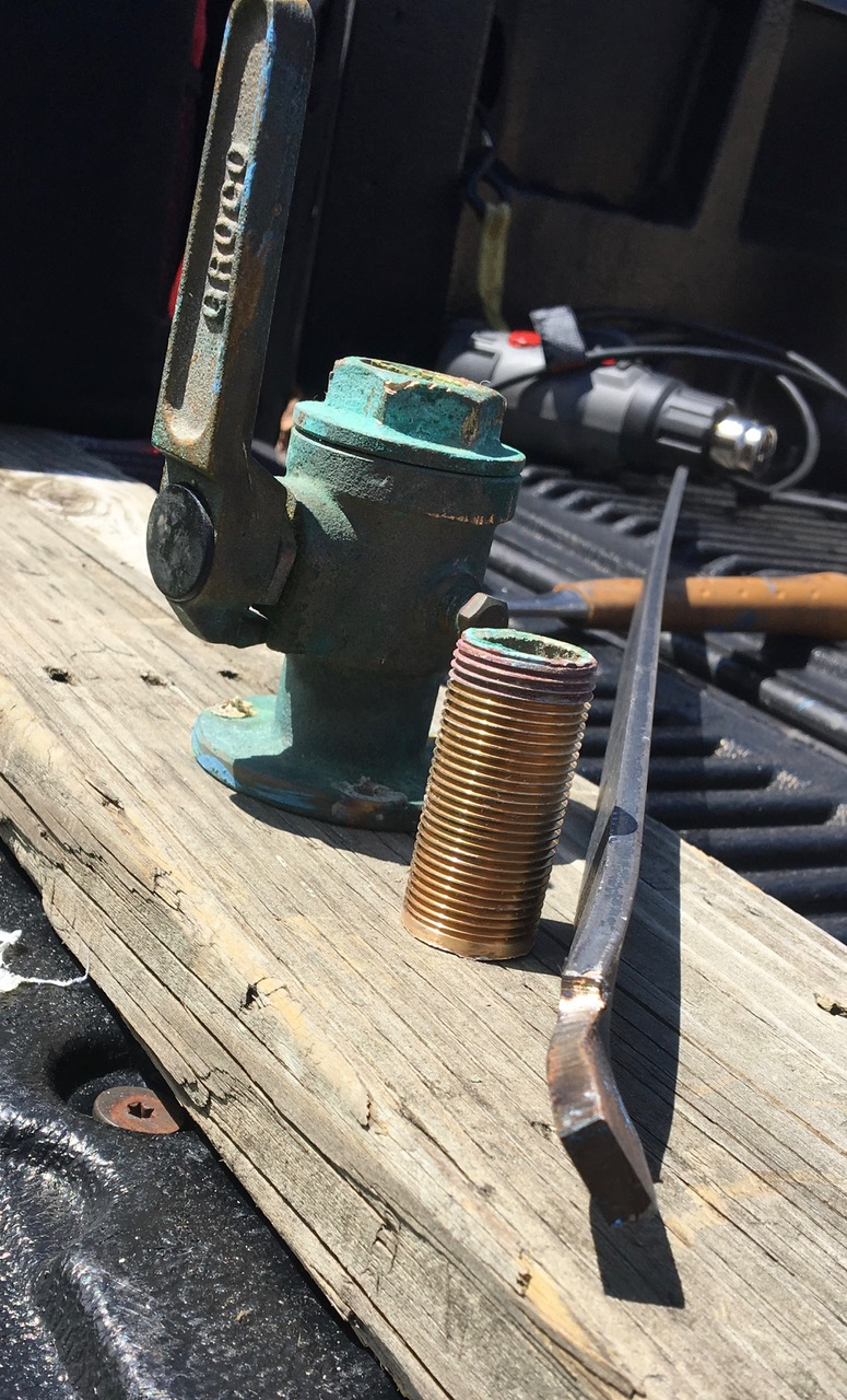

Hard to tell. Easy to make a tool from a ¼" x 1" iron bar. Use a grinding wheel or angle grinder to notch the end to fit the thru hull. You get two sizes out of each tool you make. Cheap and easy.
Not the best photo. The bar twisted a bit while trying to remove an uncooperative thru hull.

Actually, I don't think this step wrench would work for holding on to thru hulls.
When making the thru hull wrench from a piece of flat bar, I found it necessary to ensure the two biting edges were 90° to the flat face and sharp as a razor to get a solid grip. They were also wide enough that that they had to be lightly tapped into the thru hull.

Thanks for an accurate answer. I'll measure the ID of the thru hull when I'm at the yard later this week. I've seen tools made of steel pipe, bars and old sockets
