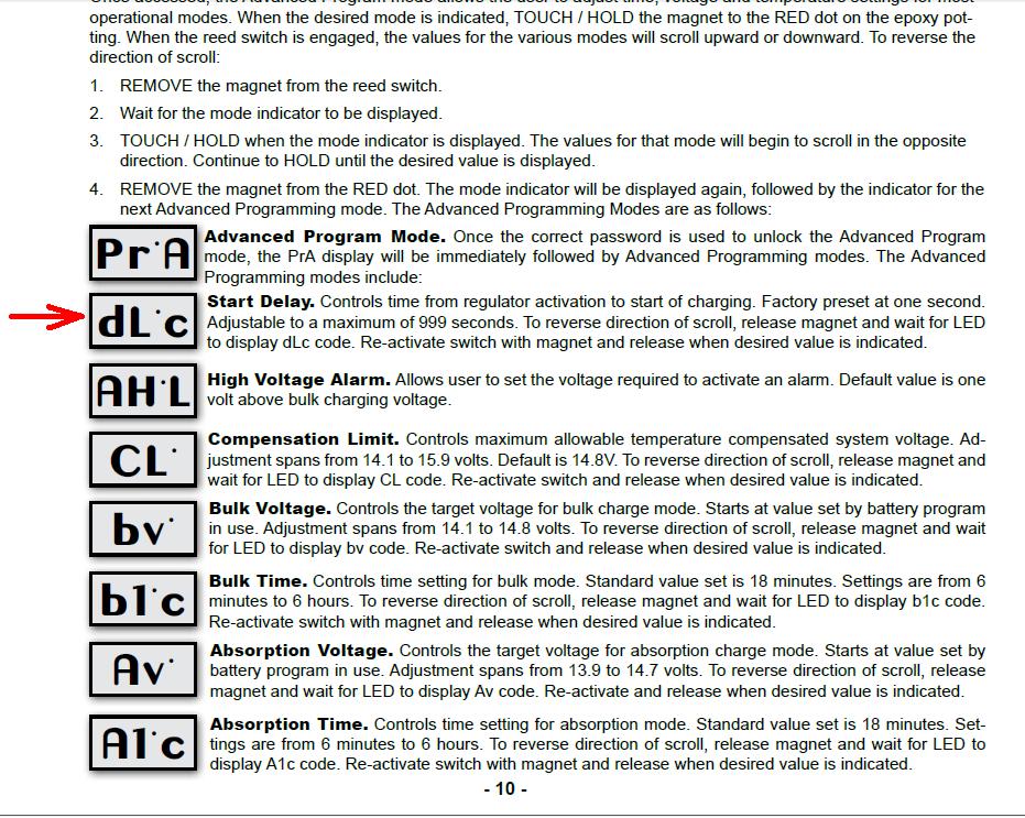

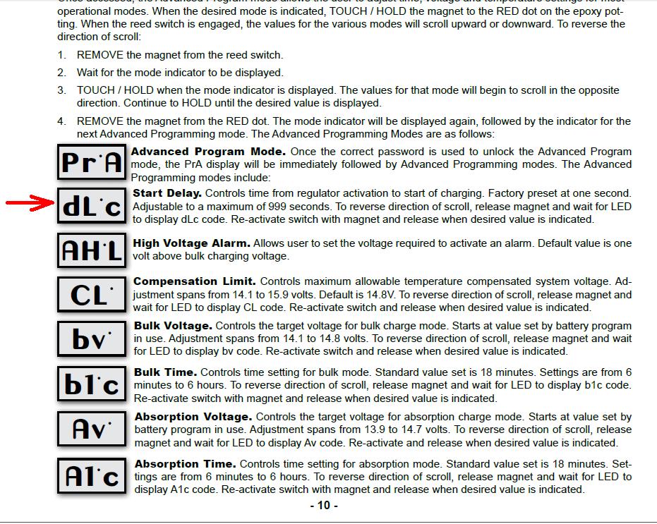

A quick way to eliminate the alternator from the equation is to temporarily increase the Start Delay to about five minutes and see if the problem rears its head during the delay. If it is unrelated, it's back to the drawing board.
