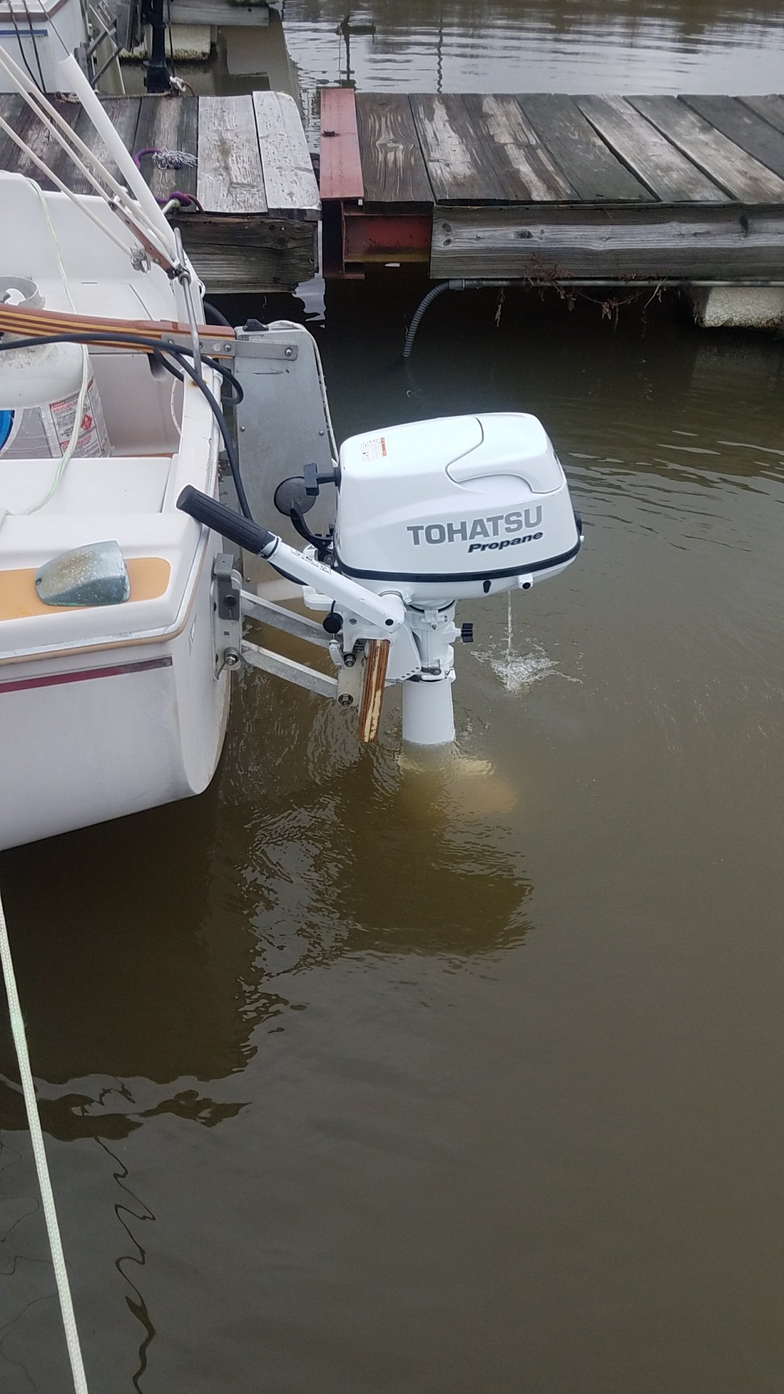

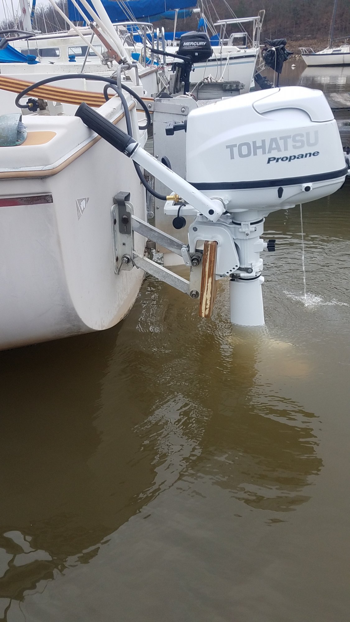

The motor ran fine in my bucket during breaking, water level was just above the horizontal fin does the cooling output stream. Installed the motor, it s a long shaft. I believe the old motor was a regular shaft. The prop is deep in the water when lower the motor stand. It bubbles when it runs....
13,449
Are the bubbles from the exhaust? Many engines send the exhaust through the prop, this helps to quiet the engine.
On a sailboat, the deeper the prop, the better. It will be in clean water and less likely to come out of the water in waves.

It is more exposed to following seas . If in salt water, more potential for corrosion. I would refer to the owners manual for any cooling issues but I wouldn’t think there would be any.

Be careful that the motor head itself does not get wet while heeling...in that instance a motor can be place too low. Especially if the motor is offset from centerline.

When sailing, raise the motor and tilt it, that will reduce the chances of submerging the engine head and it makes the boat more fun to sail.
Back in the day, I had a 22' boat with an outboard. When the engine was raised, it never came close to getting wet and I was out in some conditions that I probably shouldn't have been. I think submerging the engine is a pretty low probability event. I wouldn't worry too much about it.

If the power head is under water the motor is too low. The cowling will hold back water and provide air for about 5 seconds.

The 2 Tohatsu that I've owned bubbled at the joint between the extension and lower unit. I was concerned but Tohatsu said it was normal. There is not an exhaust gasket at that point.

It looks perfect to me. The reason you get along shaft is to get the prop deeper..... I don't see what your problem is.
I had a motor submerged a couple of times on a very windy night. It kept on running as if nothing ever happened.
@gtg What exactly are you worried about with your setup? The bubbles?

As long as its peeing it's fine your not a planning boat
I guess I'm just used to ski boat motors. Ski boats motors dont dip that deep in the water and then the water parts around the fin next to the prop. My fin is way underwater by 6 inches. AND the dang thing is hard to steer is that an angle I should learn to like? The motor is more quite.

Hey, GTG, I get it. I understand your concerns. When you're used to a planing hull, you want that lower unit only as far under water at speed as you need to get water flow for cooling. Any more, and you're introducing unnecessary drag which slows you down. But with a sailboat, it's all about drag and going slow! :biggrin:
Keeping it low while motoring is good, as noted, to keep the prop in the water with steep chop. As long as the power head stays out of the water, you're good to go. Definitely keep the adjustable mount up high with the motor out of the water when not in use. When I sail, I raise the mount and tilt the motor, so there's no chance the lower unit drags when heeling on that side. When I'm at the slip, I don't have to tilt the motor to clear the water, which is nice because I'm afraid if I tilt the motor so that it sticks out, some bozo's going to bounce off it some time...

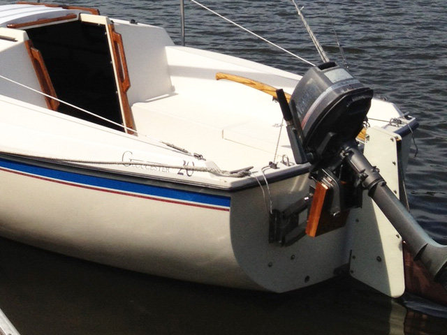

Don't they all bubble?
What's it look like under way? I raised mine because I was dragging my mounting block through the water in the original position. This isn't a great photo, but you can kinda see what I did. The two fasteners below the mount are where the lower part of the mount was originally attached. I moved the bottom end up to the top holes, made new holes for the top, and put a new backing plate on the inside of the transom. It might be a little higher than it needs to be now, but I wanted to limit the number of holes I had to poke through my boat.
