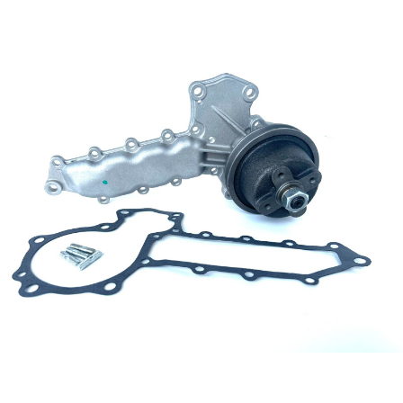

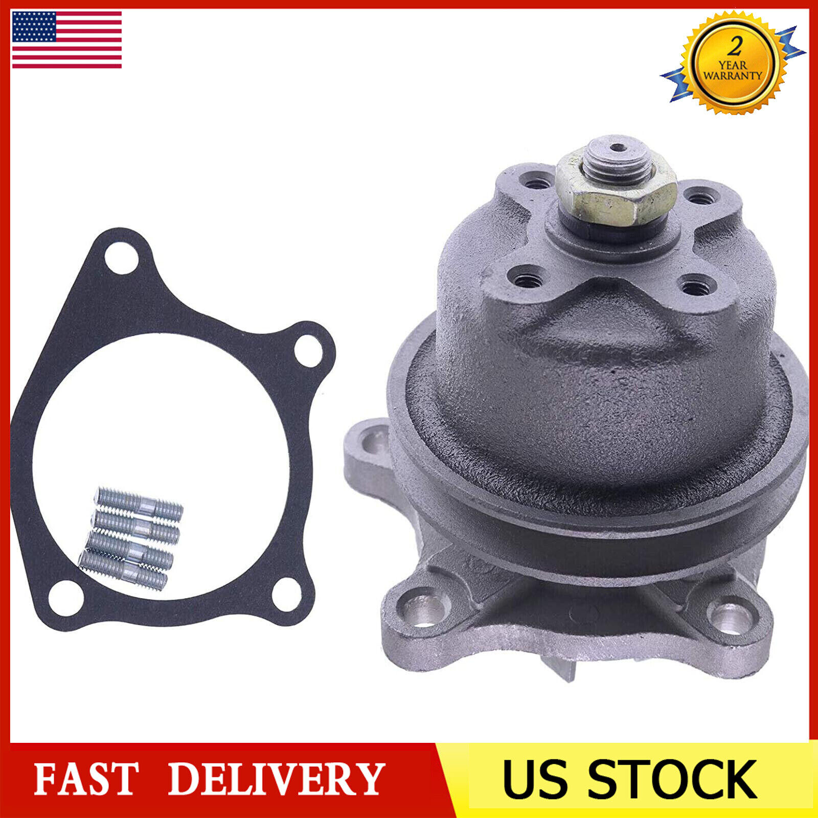

I could use your help if you have a Universal 5416 otherwise known as an M-20 diesel engine. I am in need to have a question answered. Was there a rebuild or re engineered to the engine at a later date. Reason I ask is that the my engine number plate says 5416, how ever the fresh water pump (coolant circulator) listed in the parts manual is 298845 which is a Kubota part 15401-73030. For my engine this is incorrect.
See image below
How ever this is the replacement for the pump on my engine (16 mounting holes and 3 placement/weep holes). See below:

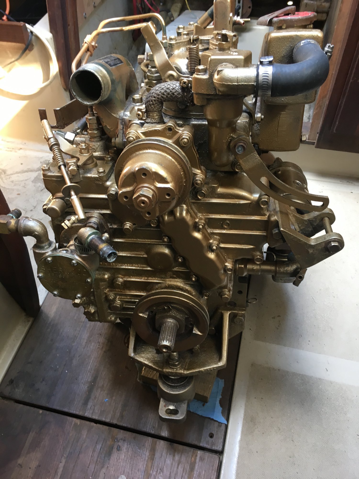

So I'm not sure which engine I have. It's not a 5411 and it's not a 5418. It is a two cylinder. Here is a picture of mine:
Anyone who can help, I say thank you in advance

hmmm...I meant 5424, but yes, you're right is it a three cylinder. The front of it looks the same to me, maybe they used some of the same parts?

Hi, I own a 1983 O'Day 30 with a with a Universal 5416 engine. I compared the picture of your engine to mine and they are the same except that I upgraded the raw water pump on mine and yours still has the original Sherwood and I added a tee and a vent valve by the water temperature sensor. I replaced the fresh water engine pump on my enigne in 2007 and installed pump # 300647 which is similar to the pump you show with the long channel on it. I believe there was a pump change/upgrade on the 5416 engine. I just went through my paperwork for the pump change and found in my notes that the first pump that was sent to me was the round pump part similar to the first one of your pictures part number # J298845. I called the dealer and told them the problem and was told that my engine needed the (Florida shaped) pump # 300647. They exchanged the pumps and gaskets and I was able to install it. I get my engine parts from Hansen Marine Engineering in Marblehead, MA.
Aug 11, 2011
1,020
O'day 30 313 Georgetown MD
Thank you GeorgeC. This is the information I needed to confirm my thoughts. I have already purchased the "Florida" style unit, I just needed to confirm. I have found that there are two styles. One with 15 mounting holes and one with 16, both with three alignment peg holes. I counted the number of bolts and nuts on mine and your #300647, confirms my purchase. Thanks again. Happy Turkey day to you all!
