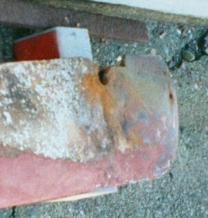

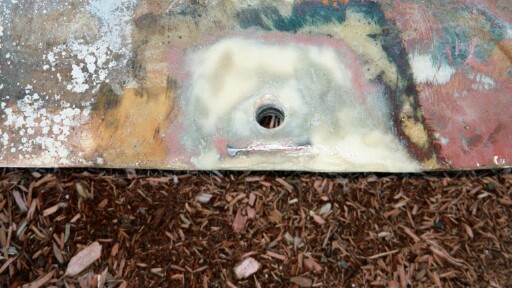

I live in Boston area and in the summer the boat is on a mooring in front of the house on the island with the keel down. . The 21 is hull#508 and has been on the trailer for about 14 months. Last time I got ready to haul it and went to winch up the keel, it got stuck when it was almost all raised. Turned out that water has gotten into the area around the pivot and rust has developed, swelling the keel so much that the it is actually unable to retract all the way.
I know I'll have to pull the keel out to inspect and maybe rebuild it. It could have been worse in that the rust might have caused the pivot to fail with catastrophic results. But now I'm looking for advice on pulling the keel out and going from there. If anyone has BTDT I'd appreciate some tips. Rod Johnson are you out there?

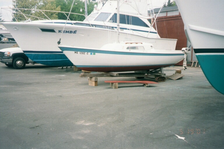

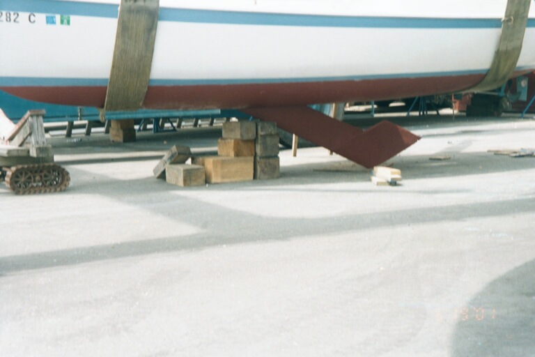

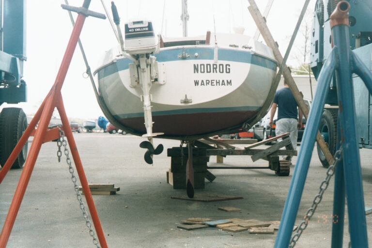

Well, removing hte keel is not "easy", but is not "HARD" either. The "not easy" is only due to the 360# weight and the need to get the boat suspended or supported is a way that allows the keel to come out. She doesn't need t obe all that high up, maybe 3' off the ground ,2' might even work. I would support the aft end of the keel on the ground, braced side-to-side if possible to avoid it toppling over to sither side as it comes out. Support the forward end (upper?) with a jack, then go aboard boat and remove the pivot bolt. Now, carefully lower the top of the keel out of the boat. Once out, you will need to lay the keel down on one side and move it out from under the boat. The 2-3 times that we had our keel out were all at a boatyard, and frankly....... getting it out wasn't hard, since hte pivot had rusted out and the keel more or less fell out. Well, the first time.... we removed it it fell out while the boat was on our cradle and thankfully my Dad moved out from under the boat just in time! The next 1-2 times the keel was removed when I wasn't there, by the boatyard crew.... but I know the last time it came out there was no doubt that the pivot had rusted out (thank goodness for our locking bolt!!)
I think there are still pictures and descriptions of rebuilding a CAL 21 keel on Richard Fuller's CAL 21 Web site (www.cal21.com) but if not...... let me know and I'lll see if I still have the info.
I'll post a couple of pics showing our keel going back in in 2001, should provide some hints about removing.
