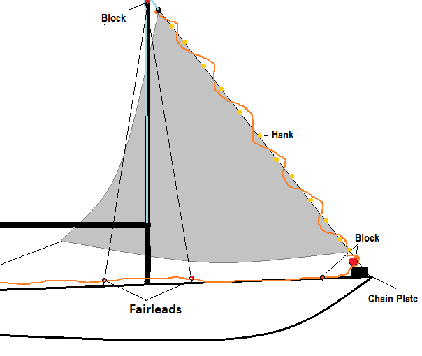

On sail handling for your jib. Have you thought about putting in a down haul system for your foresail? It will make dropping and taming your sail during a blow a joy. AND IT IS VERY CHEAP TO INSTAL. If you want to test if it is for you, just get a few cheap pullys from Lowes and see if you like it. You can upgrade to real blocks later if you decide to keep the down haul system. If you keep one of the sheets tight as you drop the sail, it will flake the jib nicely along a gunwale and it will stay there nice and neat until you have time to deal. And now it is safe to go forward without getting beat up by the clew of your jib sail and you can hank on the storm jib in peace.
If you are unfamiliar with a jib down haul, I have made this crude drawing.
Before you drop the jib, pull one of the jib-sheets tight and then release the jib halyard and pull on the down haul. That is it!
If you are unfamiliar with a jib down haul, I have made this crude drawing. View attachment 186387
