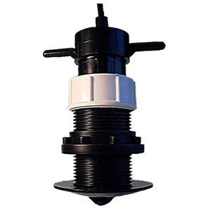

Take a look around the boat, there should be a plug (probably plastic) that fits the hole and locks in (probably a threaded ring). Many people keep these close to the thru hull. And yes, people do pull the logs when not in use to keep them from fouling. You will get some water but if you have the plug in one hand when you pull the log and are ready for it, it won't be very much. A few cups.
The plug ma not look like much, the ones I've seen/had were pretty lightweight.
In the picture you can see the ring for the actual log and that's what I spoke of to hold the log in place. The plug looked kind of like a cup with the open end up when installed.

Thank you very much. No luck finding the plug. It's an old Swoffer Brand. 1-7/8". I'm going to try to find a replacement.
