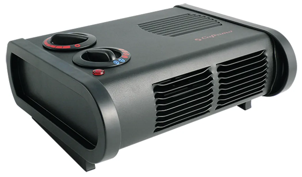

I used the Caframo heater. It has a "frost" setting. Turns on when temp goes below a certain temp (40 drgrees?).

I have 3 Stor-dry that are into their 23rd winter of service and have worked flawlessly over that time (1 in V-Berth, 1 in Aft Cabin feeding the engine room, 1 in Head). I also have a True North heater set to the Frost mode this is located in the salon That unit was replaced under warranty without question when the little LED started to flicker. I sent a video clip to Caframo and a week later I had a new heater. The only thing they asked of me was to cut the cord making the heater unserviceable and send them a photo.

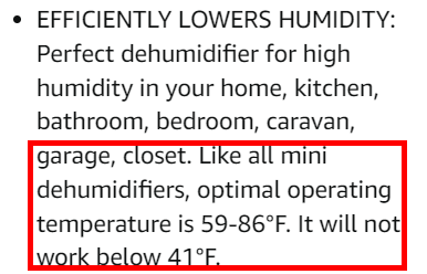

I tried a dehumidifier one winter, it didn't work below 60 degrees.

Very pleased with our Caframo flat style boat heater that has a frost setting. Been using it for years during the winter months to help protect the boat from sub freezing temps. A very dependable product.

Save your money. These little curiosities are not intended for use in unheated cold boats at low winter temperatures. As the advertisement for your above recommendation says, they are intended for use within heated houses. By the time the O/S temp. is down to 41° F. (5° C.), they've stopped working. Efficacy at O/S temp. of 50° F. (10° C) probably not much better. That eliminates most of the winter here in the Pacific Northwest.

I have the camframo ceramic heater on the boat to keep the cabin above 32 during the winter chill.

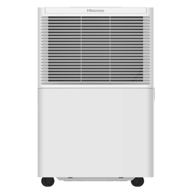

I also picked up a Hisense 25-Pint 1-Speed Dehumidifier ENERGY STAR when it was on sale a couple of years ago.
I had a window leak and I have been pulling so much moisture out of the boat I took the drain hose and ran it to a thru hull fitting on the side of the boat.
This dehumidifier manufacturer states it can operate at temperatures as low as 38 degrees Fahrenheit.
