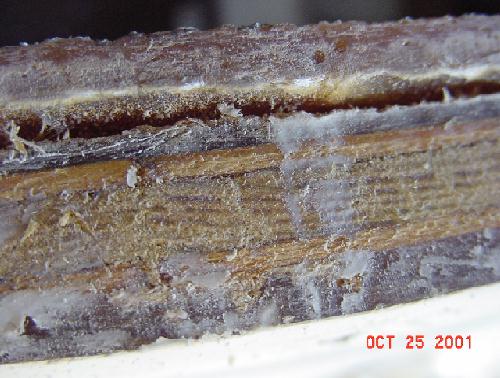

is a royal pain in the ass. After three (with two more to go), I think I have the technique for proper alignment if anyone cares. Once you have removed the old ports, carved out the deeper grooves for the new and improved drain spigots, cleaned and lightly sanded both inside and outside surfaces, install the portlight with the outer trim ring in place. Open the port and clamp the assembly together with a couple of spring clamps, or if you are lucky enough to have one, get your assistant hold the assembly together while you drill pilot holes from the inside screw holes through the trim ring, using a drill bit sized so that it does not enlarge the interior holes. Once that is completed, you will have to remove the trim ring and enlarge the holes so that the special nuts will fit flush. From there it's a dry fit of ALL of the 16 fasteners, another disassembly and then, in my case, lots of 5200 and final assembly.

Glad to hear from you! I think we all share the same sentiments of frustration on the NFM portlights. I personally have not had any problems with the leaks, I sent my chrome plated bronze ports back and exchanged them for the new 7X15 stainless series before I got started installing them and they where very accomodating to me. These involved much less filling in, actually I had to increase the cutout size a little to get them to fit. I've used three different methods of installation so far. 1) I first epoxied the delaminated wood in the core and used clamps to get back to the factory thickness. After that set I drilled all the holes and fitted the portlight, I then masked off the area and used Life-Seal (Silicone, Polyurethane mix) and screwed them together. Huge mess of oozing sealer at a use rate of almost one tube per 5X12" portlight. 2) Did the same epoxy fix but used EDPM as a sealer, worked well and no masking or mess. 3) This method worked the best and was extremely quick compared to the other methods but it is a permanent installation. I prefit the port dry, then mix and coat the core with epoxy. Install the port with two wood screws on the inside just to hold it in place, fill the voids with the epoxy and filler from the outside flush to the cabin side and clamp the whole thing together so that I have a uniform thickness to the cabin side by squeezing the inner and outer liners together using the portlight frame on the inside and a couple of 1X1's on the outside. Just before the epoxy kicks over hard I relieve pressure and scrape all the excess off the outside, the port is now permanently epoxied in place. I now drill the holes thru the cabin side from the inside half way out, take the trim ring and mark each threaded insert location with a dab of black silicone, slip this over the spigot until it touches the cabin side and you have your outside hole locations marked. I drill those to meet the inner holes, fit and enlage the holes to accomodate the outer ring inserts, put butyl rubber all the way around and screw it down. Works great! Won't be coming out! And I sure hope I never have to take them out! Actually, the trim ring comes off for resealing if you have to. The only problem with the portlights now is, the same problem everyone else has had with the NFM's. They don't drain! Tom Hadoulias S/V Lite Chop
