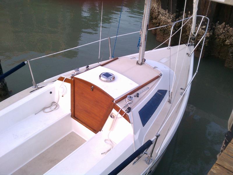

2. I have been scouring google images for pics of Catalina's with winches on the cabin top, most have added winches, cleats and blocks to the coaming. Except for the one pictured below. It looks like they have just added a block and then pull the sheet up to the winches on the cabin top. Does anyone have any experience with this setup? My goal is to drill as few holes into my new boat as possible!

My boat's rigging looks just like this except for the block and track located near the safety line stanchion.

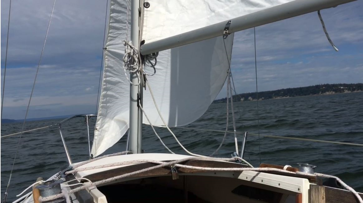

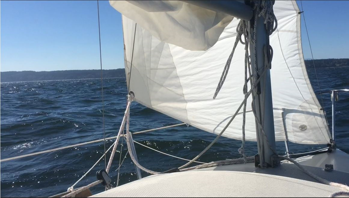

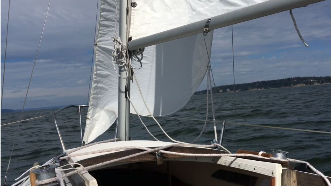

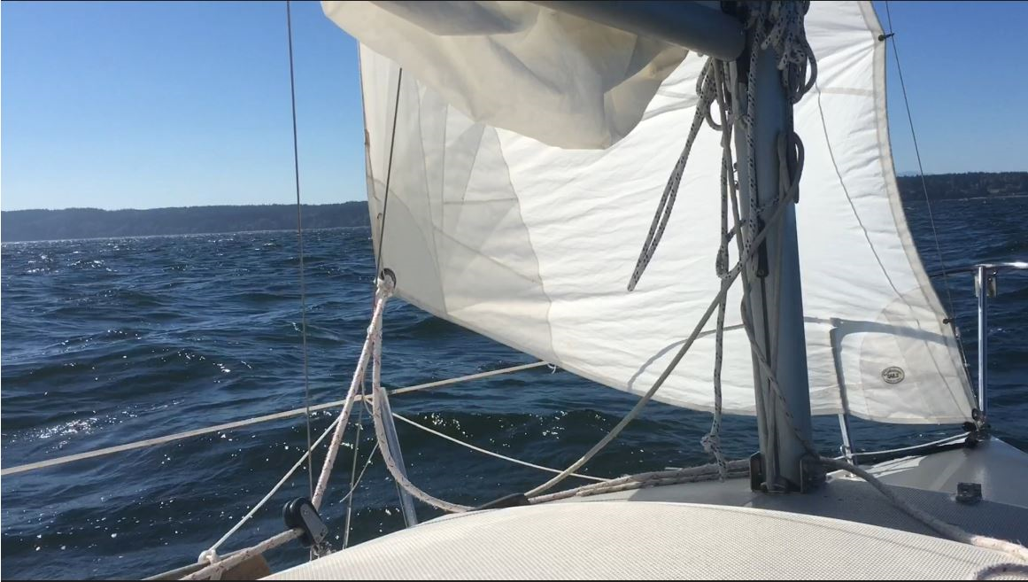

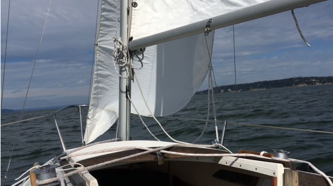

With my current sail, I can't imagine ever needing to move the block from its current forward most position. If I did, the sheet would rub against the shroud, which I assume is not desired. Below are two pictures of my jib sheets, one close hauled and the other on a reach. In both cases, if I was to move the block aft, the sheet would appear to rub against the shroud. This lead me to believe the block track was used to adapt to a different sail size.
However, as I visualize a larger sail wrapping around the outside of the shrouds and moving the block aft on the track, it seems the sheet would rub against the other side of the shroud, particularly on a reach. (Admittedly, it is difficult to imagine the angles, which is why I am looking at purchasing a cheap used sail just to test.)
This lead me to believe the point SG makes, that any other sail will require a new block, winch, cleat arrangement.
But that is what generated my question about the need for the cabin top track at all. If I can't imagine a need to move it with the current sail and any other sail will require a new track, why the track on the cabin top?
I do solo most often. I also cross the sheets across the cabin top and use the upwind winch/cleat, often using the bowstring technique to tighten. This can be seen in the bottom picture. SG mentions that the sheet should not rub against the fiberglass. Is that to prevent wear on the line or hull or both?

Unrelated to your question, you could use a little more halyard tension when you raise the jib.

After more reading the early c18’s came with only cabin top winches. Try moving the car all the way back and route outside the shrouds.

What I'm seeing on your close reach pic (along with tightening the halyard) is you need to move that car back and probably outside the shrouds as @LeslieTroyer said.

It would appear, if the angle of this photo is accurate, that the car in question is actually too far forward. The sheet should intersect the sail at about the 1/2 way point, simply stated, between the top and bottom. The angle observed here suggests that it's way, way too far up the sail, and moving the can back would not only allow a better sail shape, but make controlling it it easier. (and tighten up the halyard)
Likes: DrJudyB

3,972
