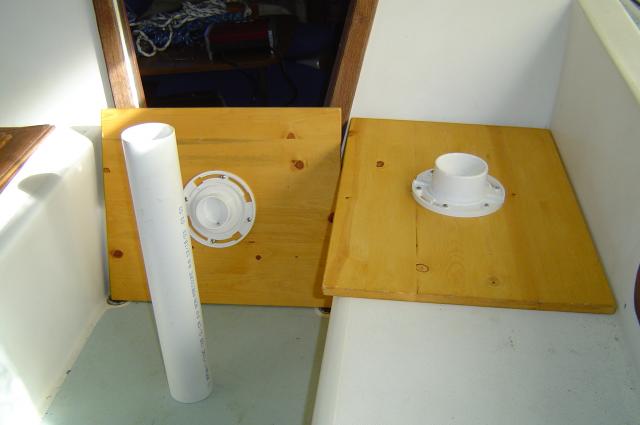

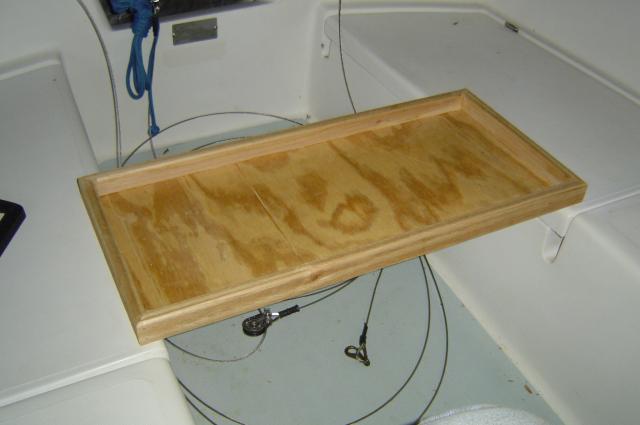

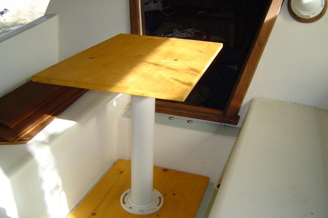

easy cockpit table
Here is what we use when cruising, with the old style boat I can't tell you how many years it's been since that cabin table was in the upright position. The cockpit table was made using two three inch closet flanges and a piece of three inch PVC. The table top and bottom were made making one cut in a table top piece of laid up board bought at one of the big box stores.
The second table is a cross cockpit table we use when making coffee or just need a lunch table.
