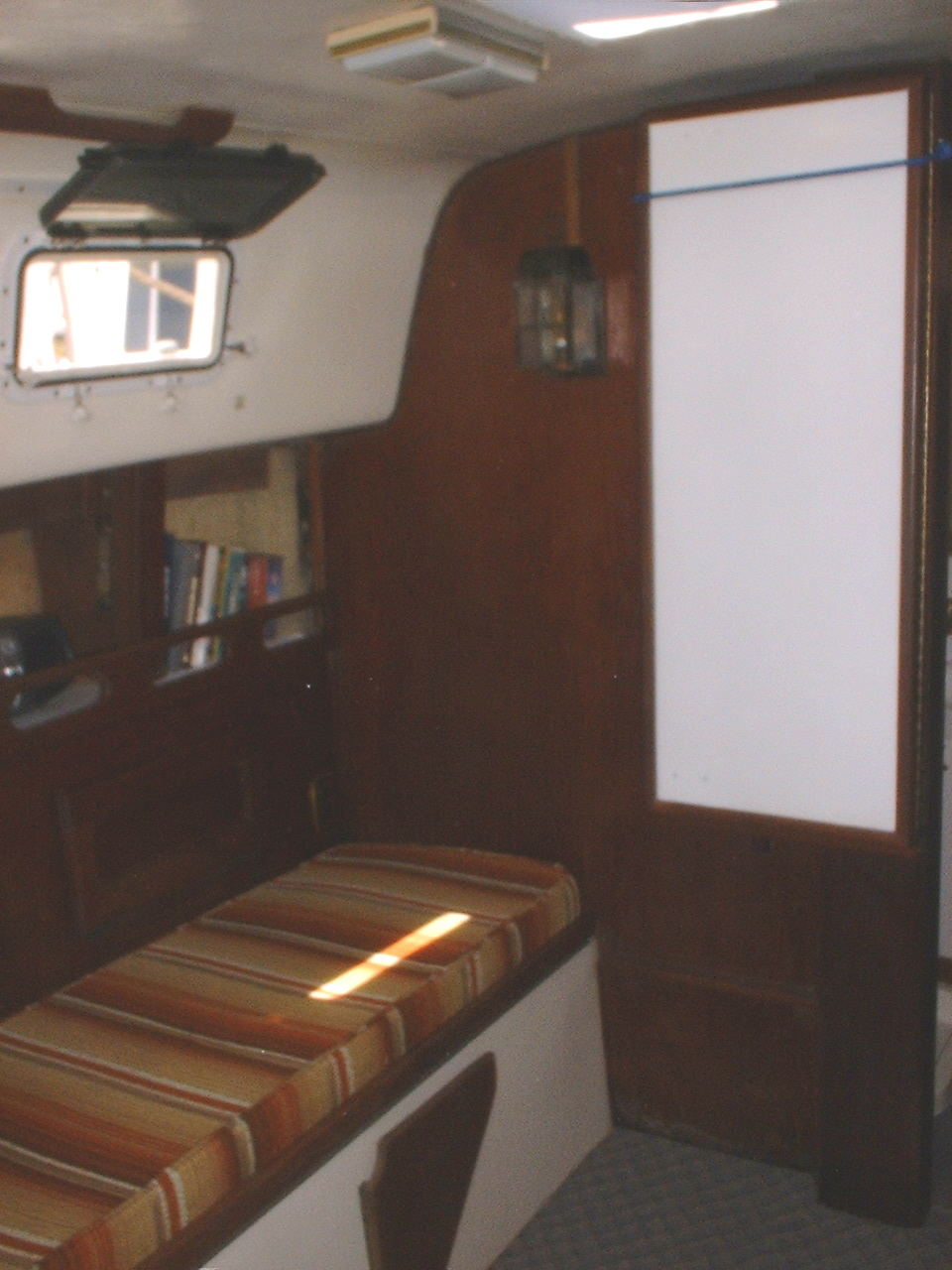

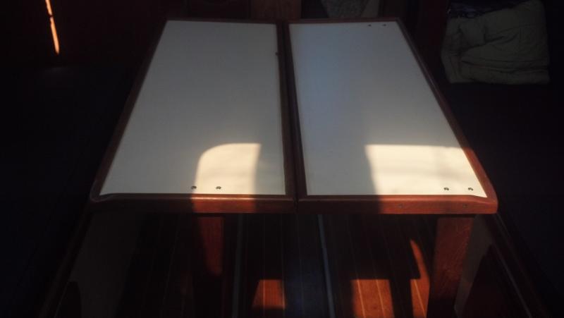

The hardware is fairly straightforward. A piano hinge to mount the forward end of the table to the bulkhead. A strap hinge to mount the folding leg
(that holds up the table when it's deployed) on the underside - aft of the table. All available from a chandler online (SBO store, Defender, West Marine, etc.) or in your area.
The bigger job is building the table from scratch. Materials can be as simple as plywood and pine moulding from Home Depot/Lowes
to fancy with teak veneer and solid teak moulding.
