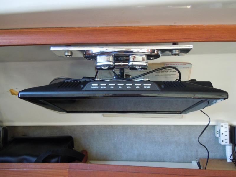

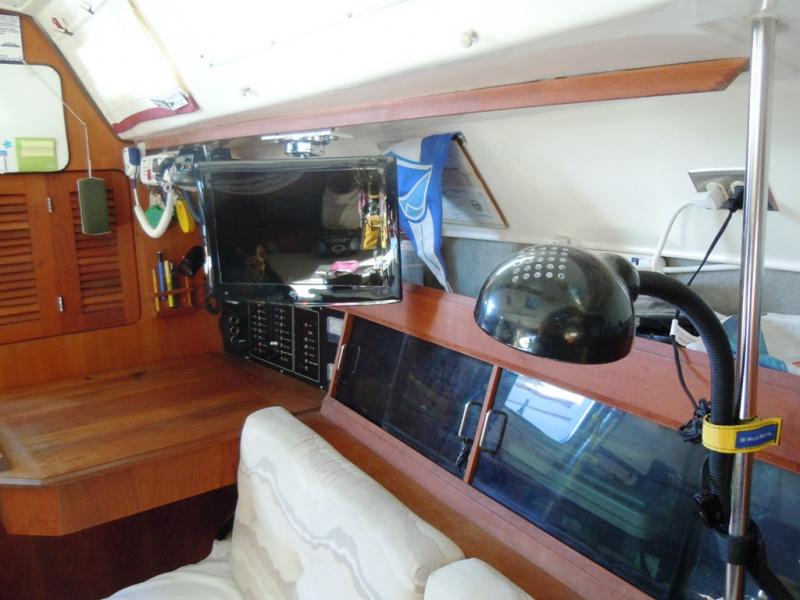

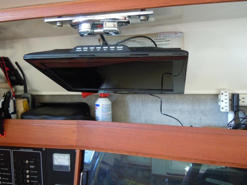

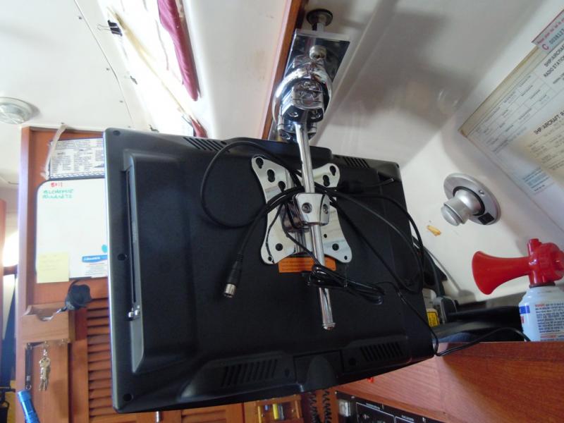

I had a LCD TV/DVD combo on a swing arm mounted to the rear side of the port side salon bulkhead (between the vanity sink). It could swivel to be seen anywhere in the cabin, including the v-berth.
I have an AM/FM/CD stereo unit mounted at the nav station, with coax speakers mounted on the port side bulkheads inside the salon (no sub woof). There were two forward-facing speakers in the cockpit's aft seating (rear channel). Music underway was always enjoyable when played subdued. DVD's on a rainy day were compensation for not sailing.
The TV's headphone output could be put through the stereo for enhanced entertainment when in port. The dinette table would be pulled and placed in the v-berth, giving a roomy seating area.

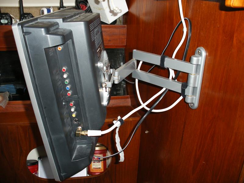

Dan,
I was going to use an articulated mount, from reading your initial post, but I was going to mount it near the compression post so viewing would be available from the dinette or settee. The sound and power cables would have been unattractively problematic. I had planned the screen to swing against the main bulkhead for underway storage or use.
I am glad you found something to work for you.
