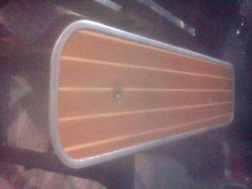

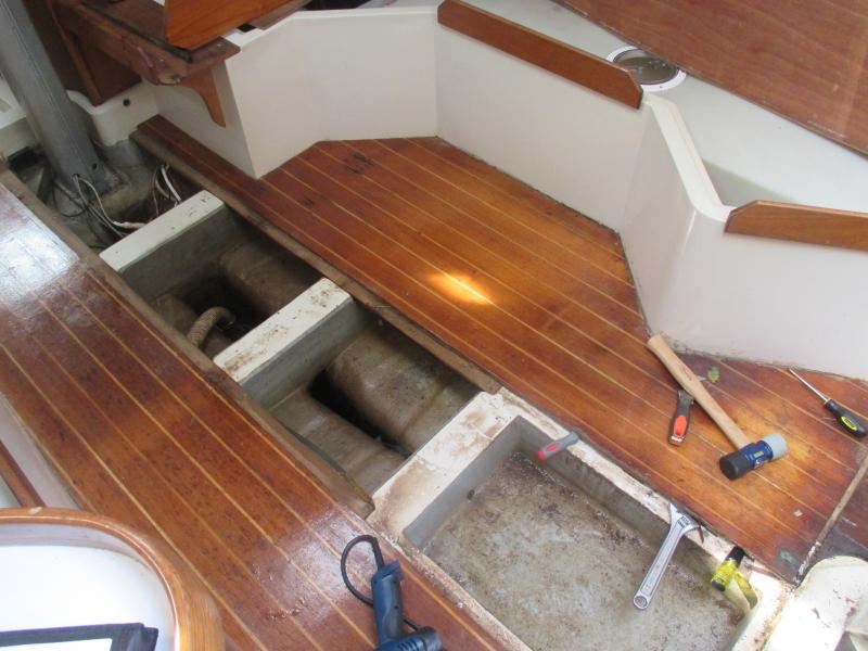

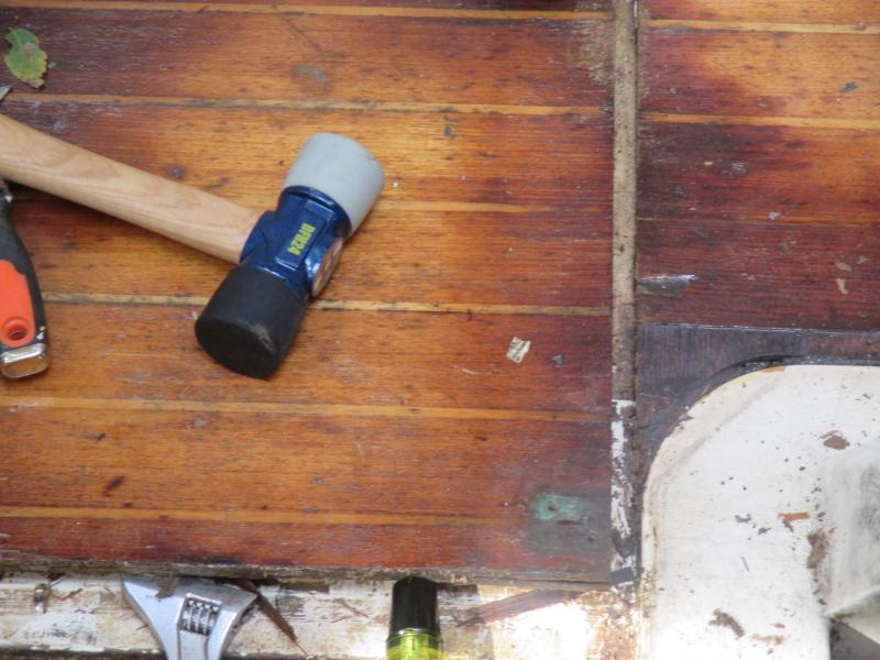

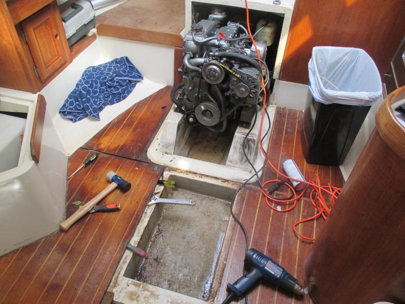

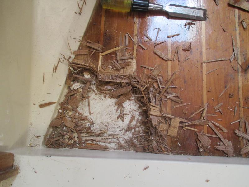

I am replacing my cabin sole, the floor has weathered 27 years of life at sea. I have refinished the floors twice, the teak/holly laminate is too thin for refinishing, and many parts of the plywood and stringers have rotted.
I have decided to document my project in three parts. Share photos and read posts for any general advice. Here's some photos of Part One, Ripping out my Soul... -Tools, heat gun, chisel, screw driver, flat bar.

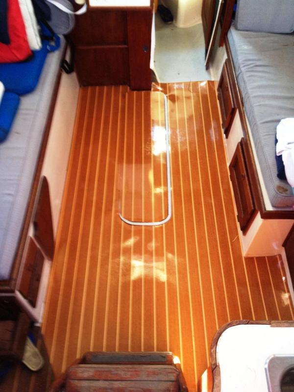

For my sole I laminated Ipe and maple. Looks very much like teak and holly and holds up pretty well...I'm digging around for pix.
Jul 26, 2009
291
No complaints at all, holding up well and still look like they do in the photos. One tip; you need to drop something on them soon after finishing the project, just to get past that first time...

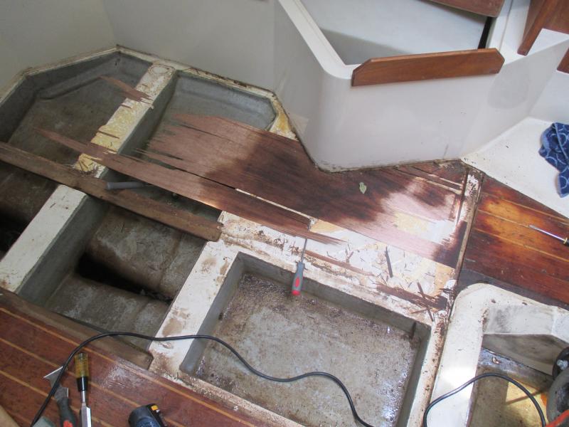

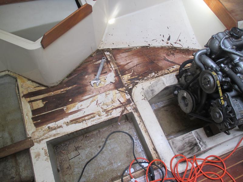

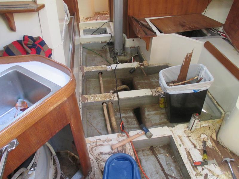

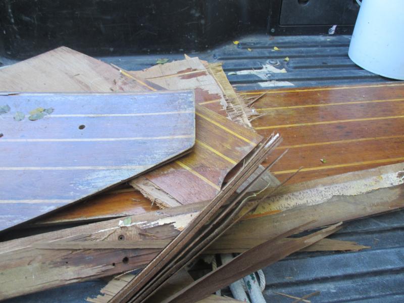

More photos cabin sole removal...

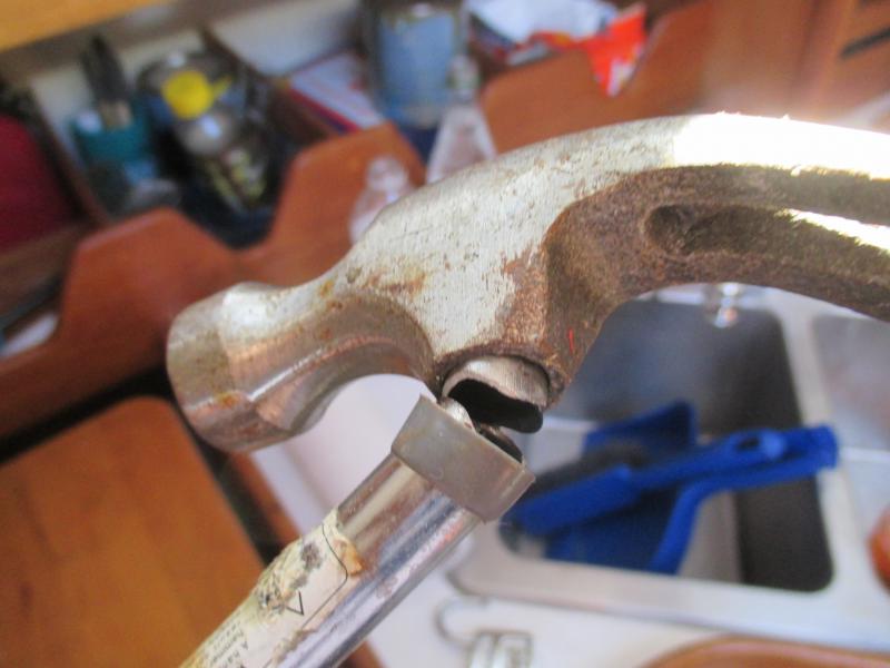

Ipe & maple would work, plasteek looks good, black walnut is another option., finished removal... some pieces didn't come out clean and broke a cheap tool kit hammer. Could be a couple weeks before I cut and prep new floor, instead of plywood stringers, I'm going with pressure treated, here's some more photos of the removal.
