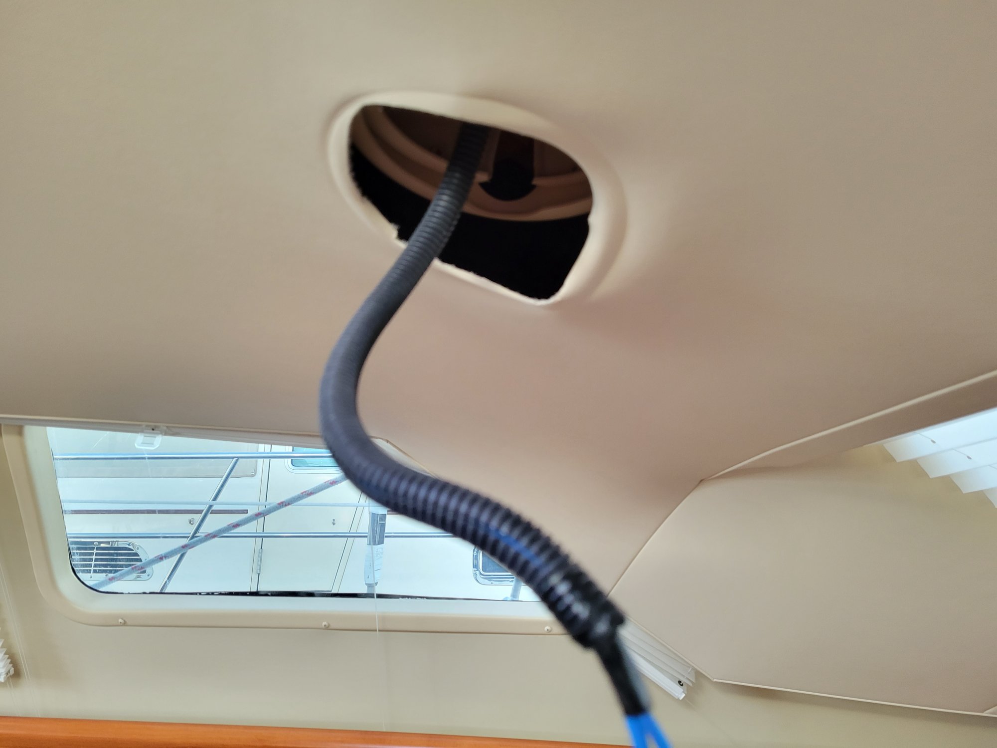

Need your help/suggestions. I have a 09H45DS. One of my main cabin lights has died. The originals are 6 inches in diameter and are recessed/flush mounted into the cabin top/ceiling. I found replacements on the hunterowners.com web site at $70 each. Ouch! I did find some LED, round, 6-inch lights that fit very nicely on Amazon. I got 5 for $45. They fit perfectly! BUT, they are super bright. Way too bright, cannot look at the cabin top with out sunglasses. The Amazon ones are 720 lumens and the ones on the Hunter site are 350 lumens. I could get a dimmer for the Amazon ones, but it’s a bit of complicated wiring, doable, just not easy. Before I go down that road, I wanted to reach out and see if anyone here has any suggestions or solutions. I imagine the 44DS and the 45CC use the same lights as well as other Hunters of this vintage.
