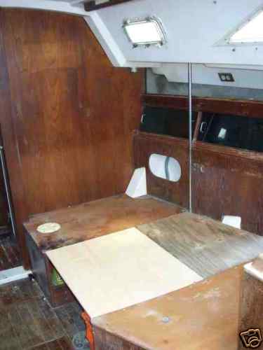

I am new to sailing/boating. I bought an '83 H31 in July. Looking at photos of H31s from '84 and '85, I noticed they have very similar dinettes but the table seems to drop to form a mid-ship berth. I was wondering what it would take to modify my dinette to be the same. Any ideas? While I'm at it, I likely will be single-handing and the mainsail does not have LazyJacks or Dutchman or furling. I figure to be able to raise the sail but dropping (dousing) is another story. I tried it once and suffice it to say, I would like a better idea. Any thoughts?
Thanks in advance.

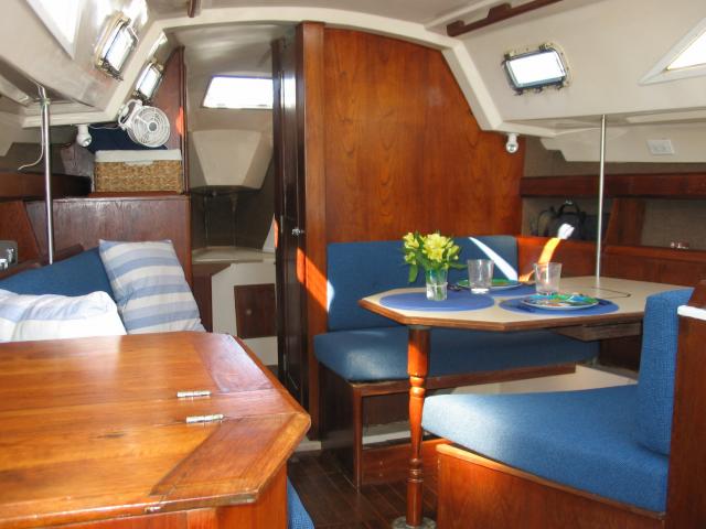

Hey ShooterII::
Welcome,,,, as a new Hunter Owner as of this past June (1984 Hunter 31'),,, I will let you now that there is NO BETTER Resource than this website, it's Contributors possess an amazing knowledge of sailing, and there chosen craft, Hunters,,, and most important, they are most willing to share their information, and help!!
I have just completed the restoration of our cabin, amongst other projects, and am most willing to offer suggestions and opinions on your efforts,,,
fyi ,,, we have Lazy Jacks,,,
let me know if I can help,,, and here is a sample of what I've accomplished,, so far , Attached,,,
Before and After,,,

You cabin re-do looks great!
Hey ShooterII::
I have the same Hunter 31 - been working on restoring/ cleaning up since Summer- its looking good! I did the cabin sole- but not the chart table and all. What did you use on that? It has a nice sheen to it that I like.. :)
Thanks!
Julie

Hey Julie:::
Sorry for the delay in getting back to you,,, --HOLIDAYS---
I used "Helmsman" Varinish, semi Gloss on the Nav Desk,,,
send me you E Mail address, or send it to me at Hunter31Coyote@aol.com
and I'll send you pictures of the rest of the "restoration" looks great!!!
happy to assist with your effort,,, been there!!!
