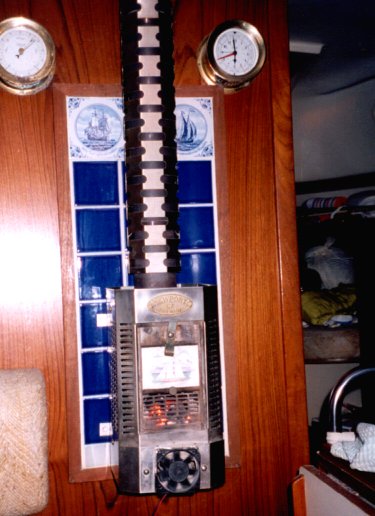

We had an Origo alcohol heater for several years. Heated alright, but left everything dripping with moisture. It could be warm but real clammy. And boat alcohol cannot be used for "medicinal purposes." It's denatured. It is also very, very expensive. We have a Dickinson vented to the outside solid fuel heater in which we burn just about anything but mostly anthracite coal and genuine charcoal. Anything but charcoal briquettes, which generate more ash that the original volume. We are very happy with it's cheerful glow and cozy dry heat but it does take a lot of tending. In a Maine situation where you might want heat 24 hours I think the diesel heater makes the most sense despite its warmup time. It would be the cheaper of several alternbatives but not as cheap as the solid fuel and would generate lots of BTUs. You could always go to an Espar central heat setup.

Another view
Hope I am not hogging bandwidth, but here is another earlier view of the solid fuel heater before we installed the forced draft blower.
