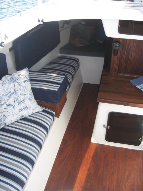

I used the laminate wood flooring from Home Deport. It is easy to put down as it sticks to itself not the sole so no glue is needed. For my macgregor 26 s it took one box which was about $50.00. It has held up nicely, clenas very well and does not mar or scratch. It has handled water from people coming in to the cabin wet after swimming with no problem. I think it omes in 4-5 different colors. It cuts very easy with a razor knofe. All together it took me about 2 hours to install and I took my time.
The light color plank in the pic is sunlight not a different colored plank.
We are very please. Even if it only last a few years $50 is a easy replacement.
If you go this route stagger the planks to give it a wood floor look and feel.
