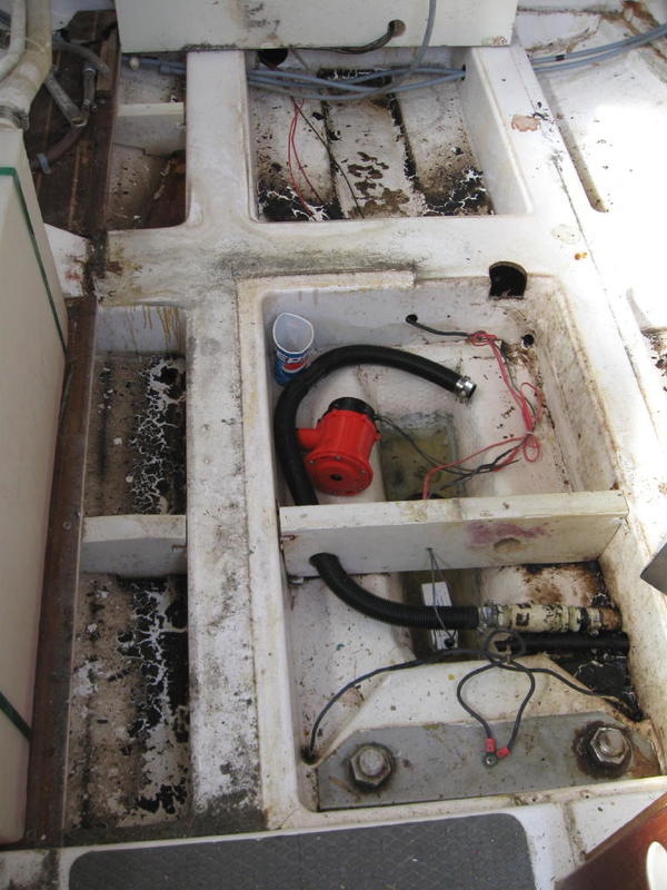

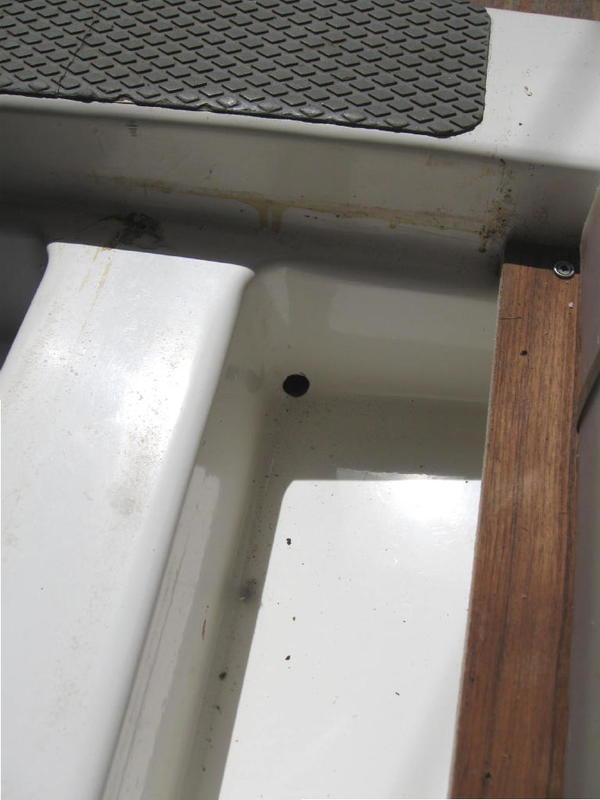

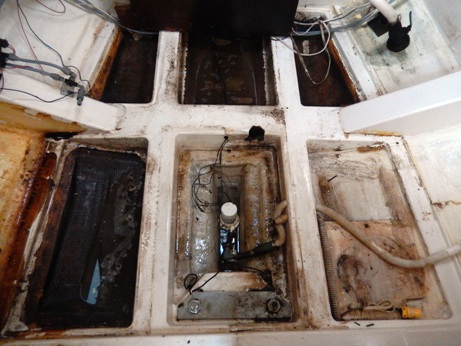

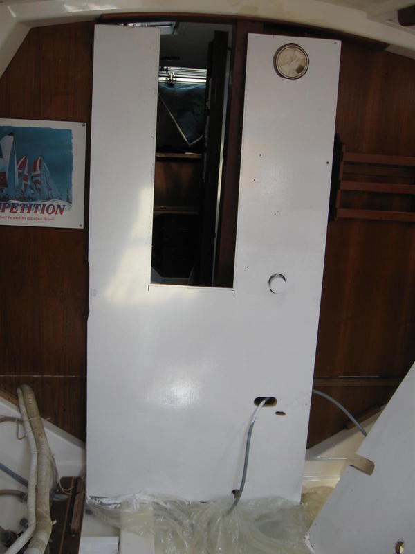

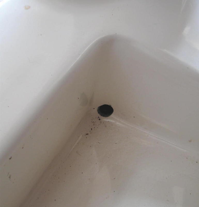

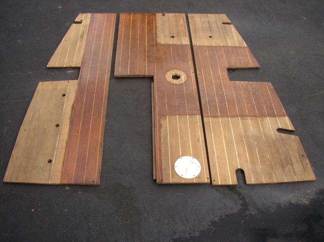

Hi Ilan,
FYI I've attached some pics of that job. You will need to remove the settees, as well as the hot-water exchanger and the holding tank from under the starboard settees. The port fresh-water tanks can stay in place.
The veneer is 3/4" teak and holly. Expensive but I was lucky to find an exact match. I painted the undersole with an epoxy paint to minimize water damage. The grid under the sole is very strong. I made patterns for the new pieces with the old ones. The only difference was that I made the new floor in 3 pieces to be able to bring it down the companion way.
Good luck with your project.
