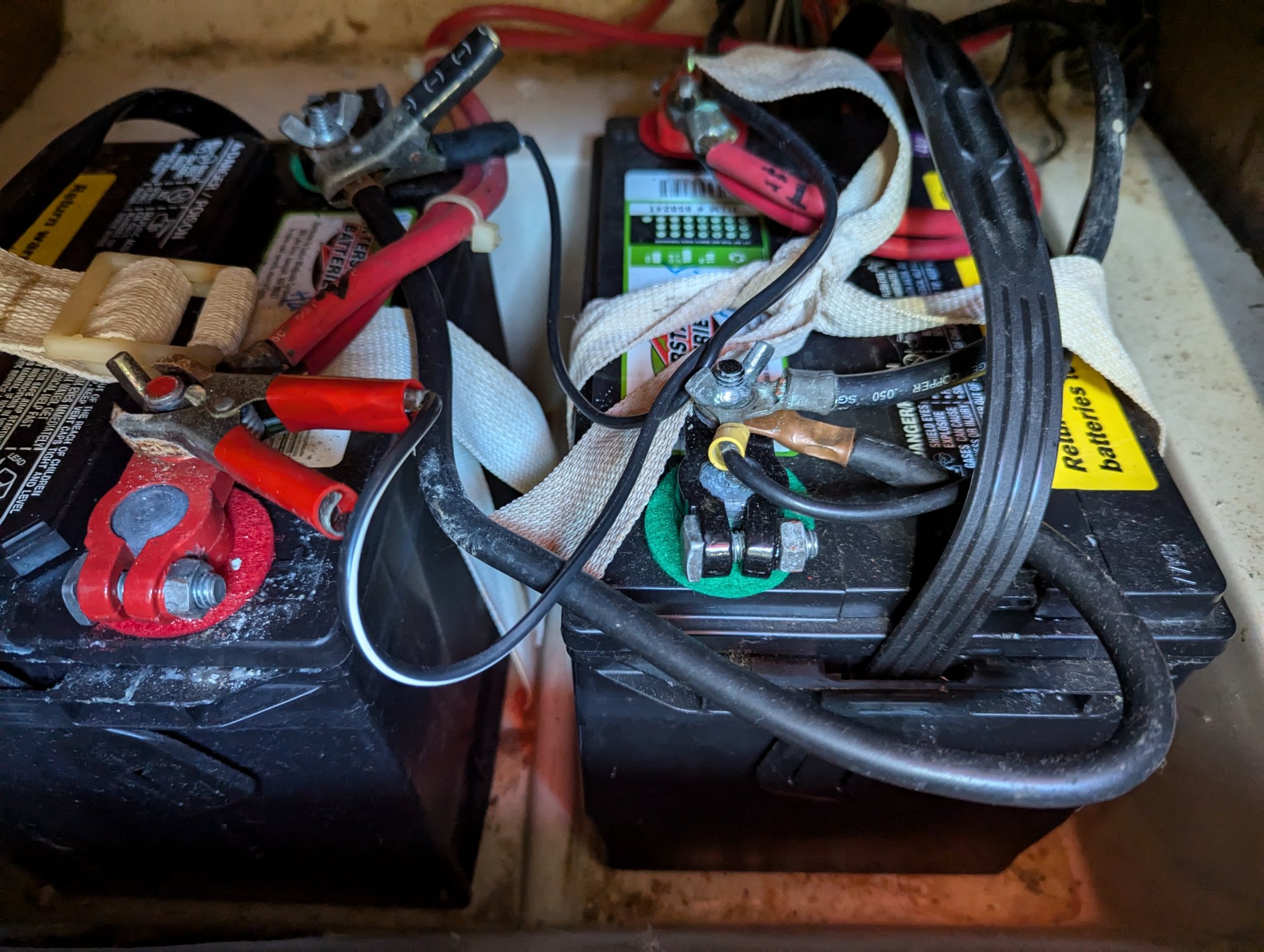

Have a '86 C30 repowered with a Yanmar 2GM... currently Interstate lead acid start and house banks. When leaving Sunday I noticed the start battery is dead (4V). Current lead acid is 7 years old and gets used infrequently (currently), what is a good recommendation for a new one? Group 24? G27? I did not record the size and I'd like to bring one with me this weekend to replace (city pricing vs marina pricing).

I'm in a powered slip but leave unplugged to preserve zinc as my dad did. I try to make a monthly trip to charge batteries. Have considered a small solar but wasn't sure that was a good idea with lead acid. Will look more into that. Pretty sure the bilge pump is run off the main/start battery. I really wish I grabbed a better shot of the batteries when I was down last weekend.

pretty much any battery will work on these small engines. Your current battery lasted 7 years, you don't need to over think this , just replace with the same , a group 24, 27 or 31 would be fine. good luck, maybe maintenance free.

A group 24 will start the engine fine. A deep cycle group or 31 gives more flexibility to use it for house loads if needed.
All lead acid batteries like sitting at a full charge. A small solar panel with a controller can help with that, or you could keep the boat plugged in and add a galvanic isolator to comfort your zinc concerns.
12,950
Seven years is pretty much the end of life for a Lead Acid battery. Stay with a flooded lead acid if the battery will be left at a partial state of charge, they are more tolerant of this condition than an AGM battery. AGMs want to be kept fully charged, if not they can die soon.
A "starting battery" is not needed, a battery to start the engine is. It can be any size from Group 24 up. Batteries marketed as deep cycle marine will have more lead and bit more capacity than batteries marketed as marine starting batteries. The deep cycle batteries will start your engine just fine.
