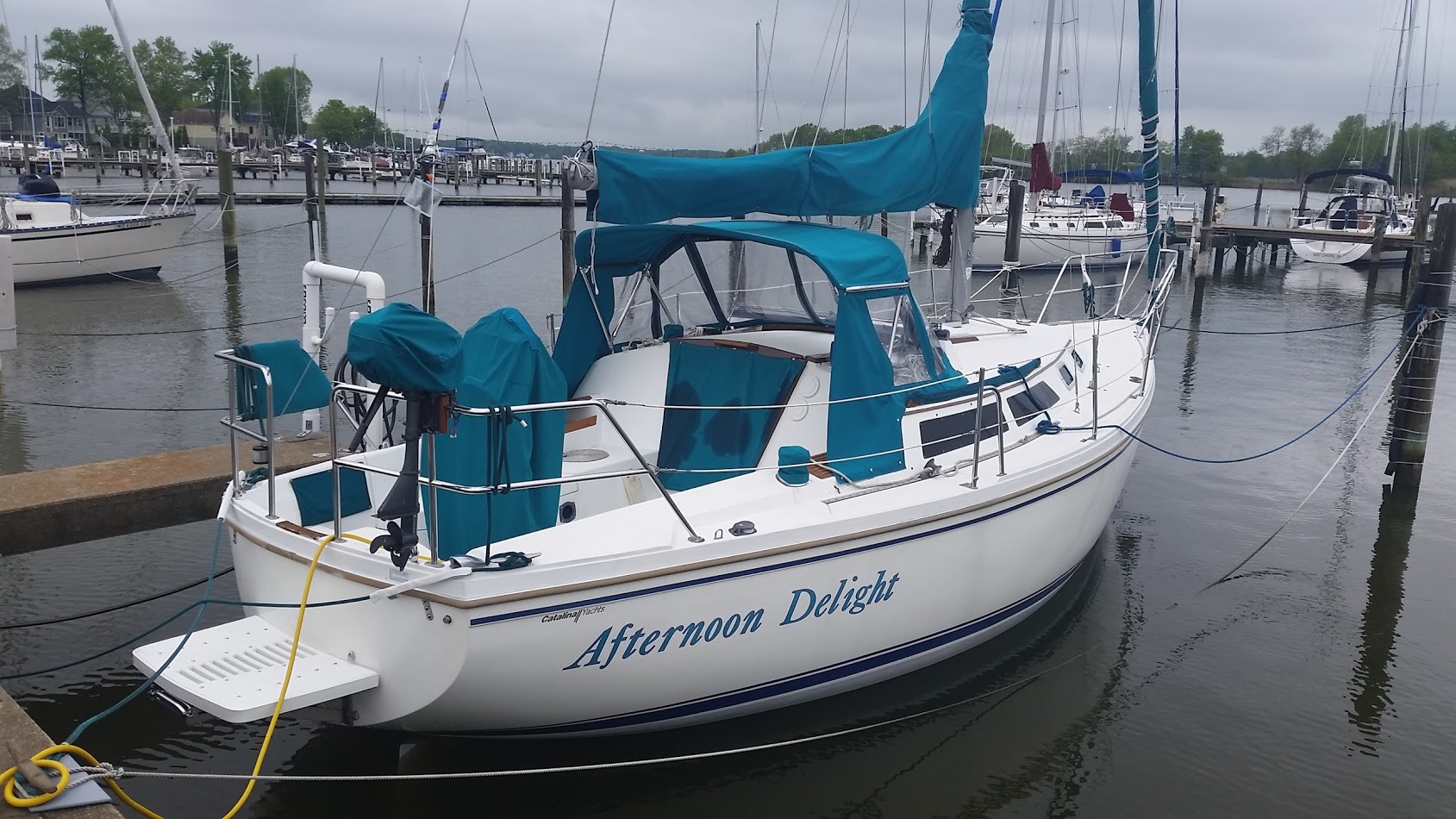

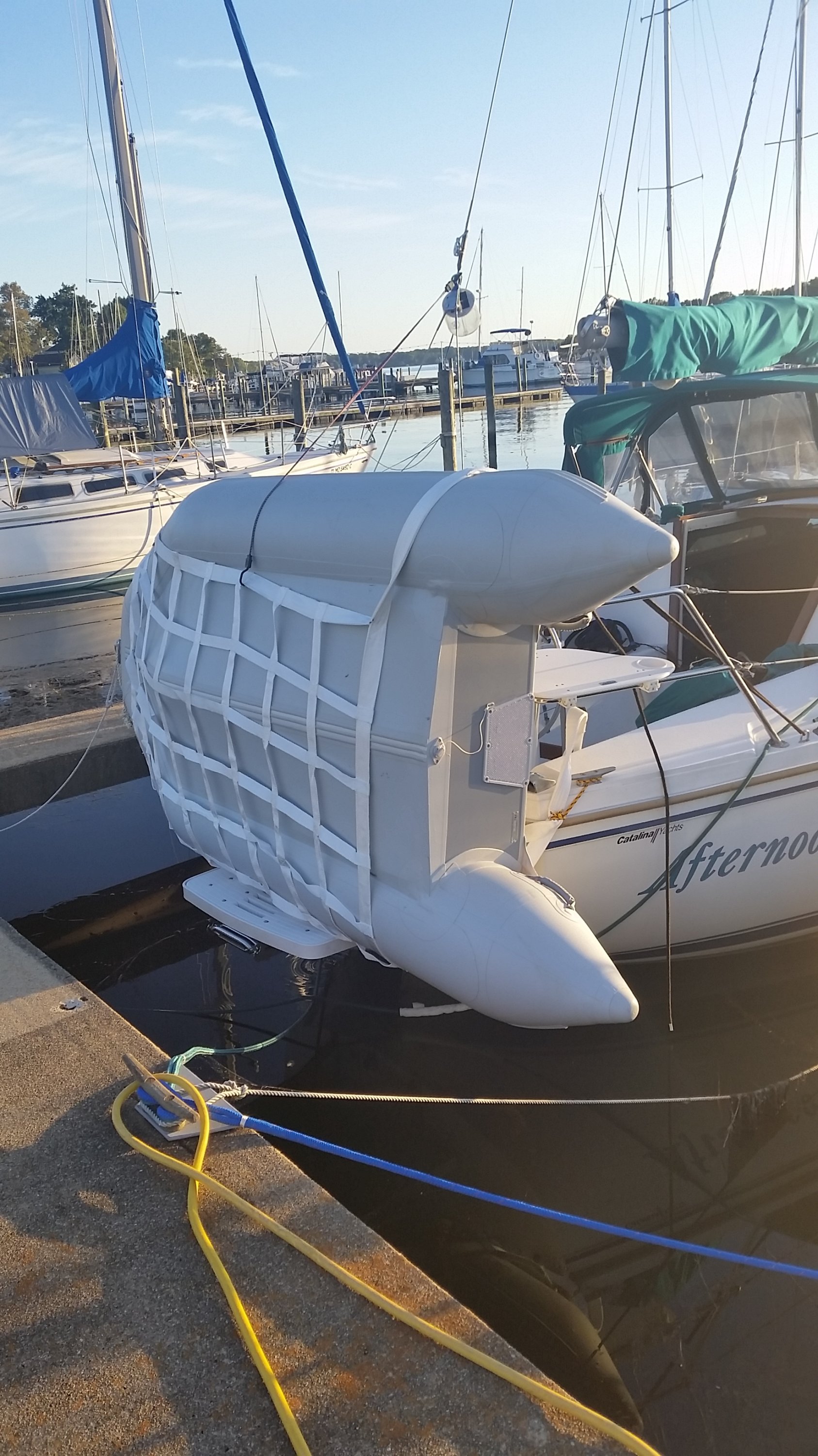

Are both boats tall rigs? My boat is a TR and I have sailed right past Catalina 30s that are not Tall Rigs and my sails are old. The other question I would ask if either has AC. Mine had it and I looked at a few boats that did not. I really didn't care about AC but I cant imagine not having it now because when others say it is too hot to go sailing, I am not that person. It is not the heat when your out sailing its when you are at the dock after coming in and before going out that the boat is a sweat box. My swim platform works at a dingy davit too if your going to go for overnights its really nice to have a dingy with you.
