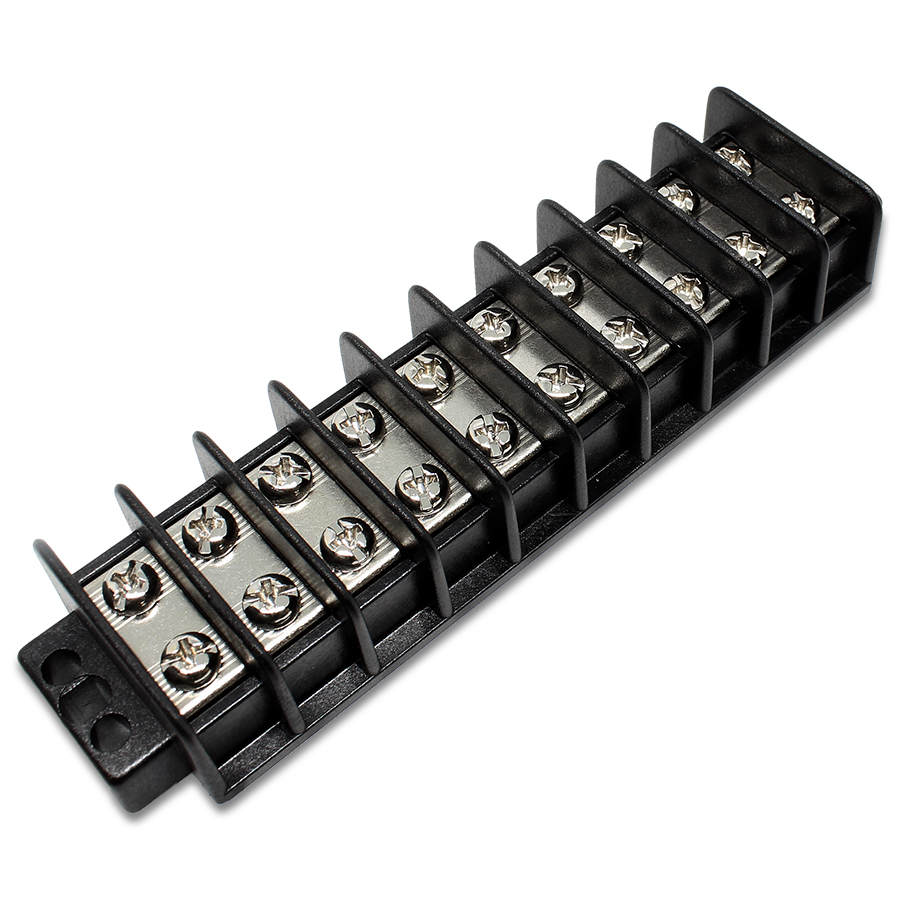

This is the style of terminal that's installed. It appears to be factory as the source wires are zip tied unlike the previous owner modifications. It does not have a connector linking all of the screws together electrically.

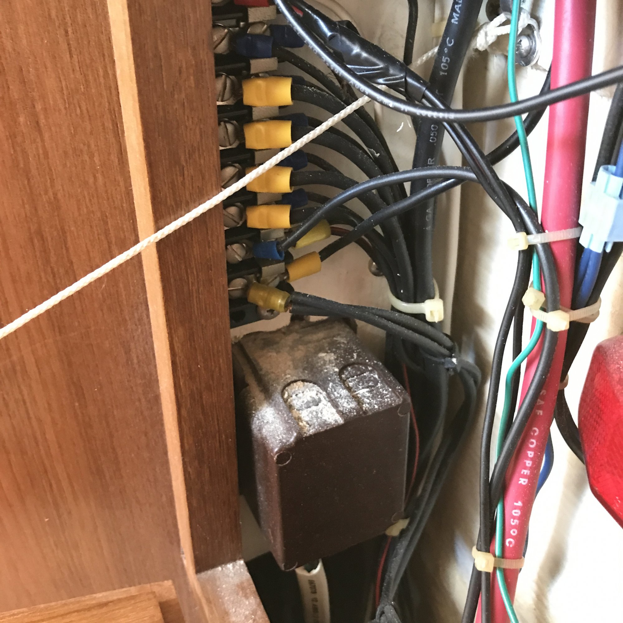

Sounds like you are talking about this ground strip on the left side of the panel area.
On my 93 there is a heavy ground wire going from that strip to the battery. #6 IIRC, could be heavier.
All of those ground wires are grounds for various devices. Terminals are interconnected.

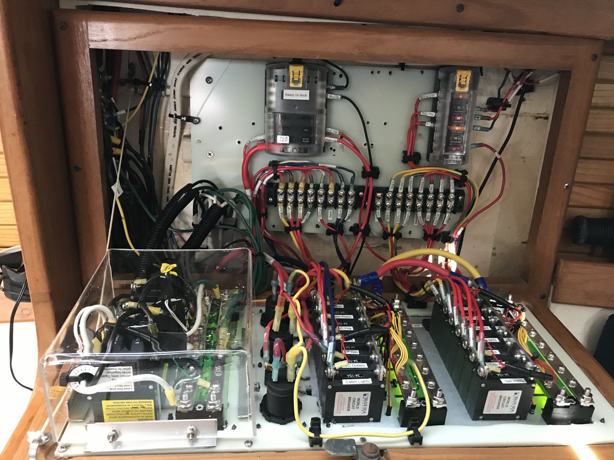

Here is what the original panel and back board looked like.

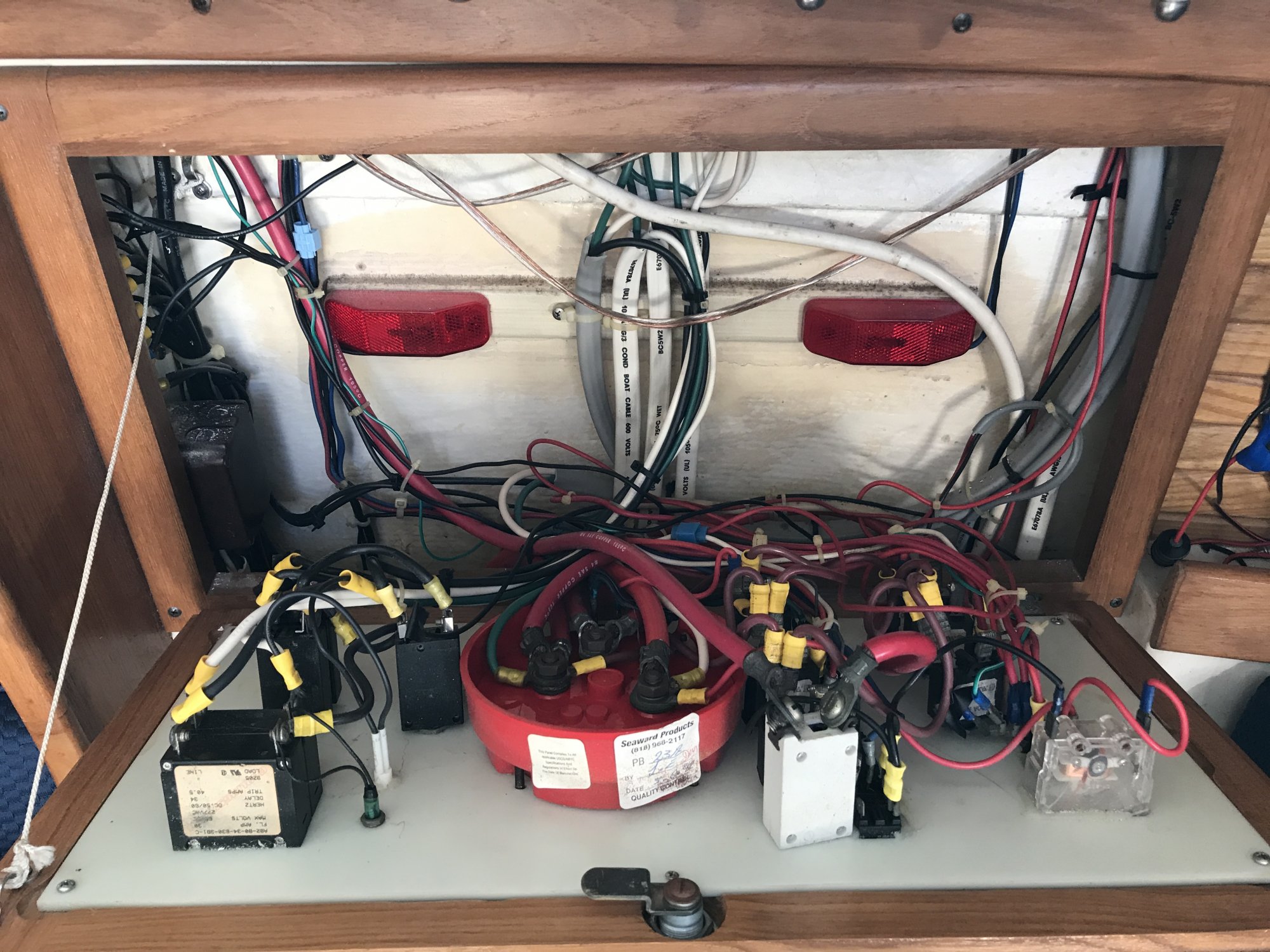

For comparison, here it is now.

Thank you @Ward H! That is the terminal strip I was referring to. I must've missed the 6awg cable. Most of the time the only common connection for this style strip is the terminal across from it. Are all terminals on this strip tied to ground?
I bought some 4awg wire for an inverter and installed a high load terminal strip for ground and one connected to the battery switch. Next upgrade is to replace the trailer lights behind the panel with an LED strip or two. The reflector is pushing some of the switches out of the panel.
Your new panel looks fantastic! If it was available as a kit, I'd buy it in a heartbeat!
