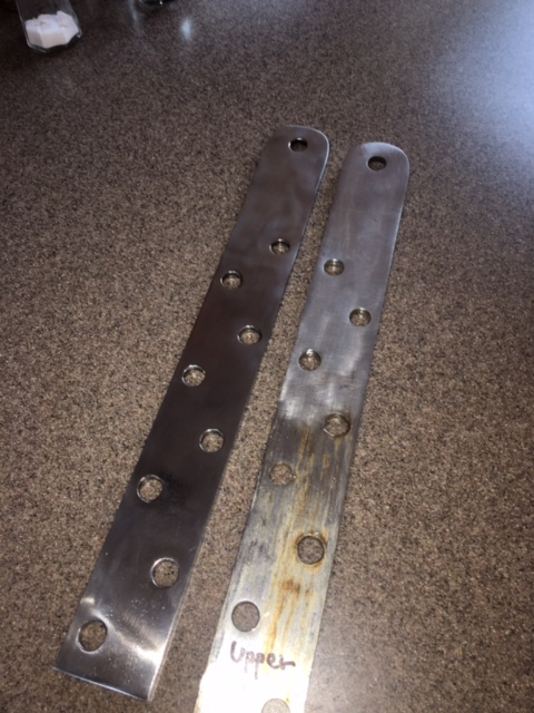

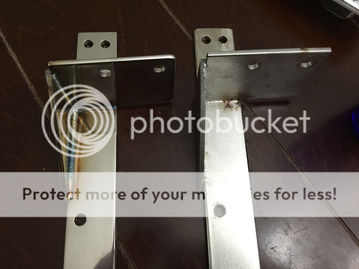

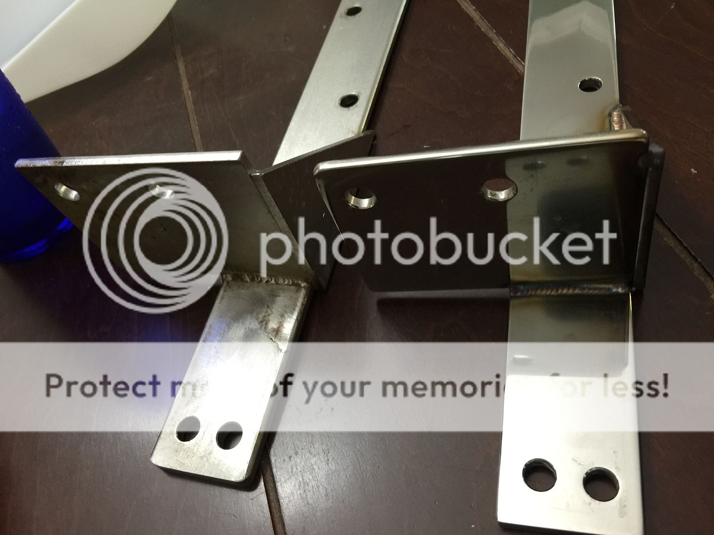

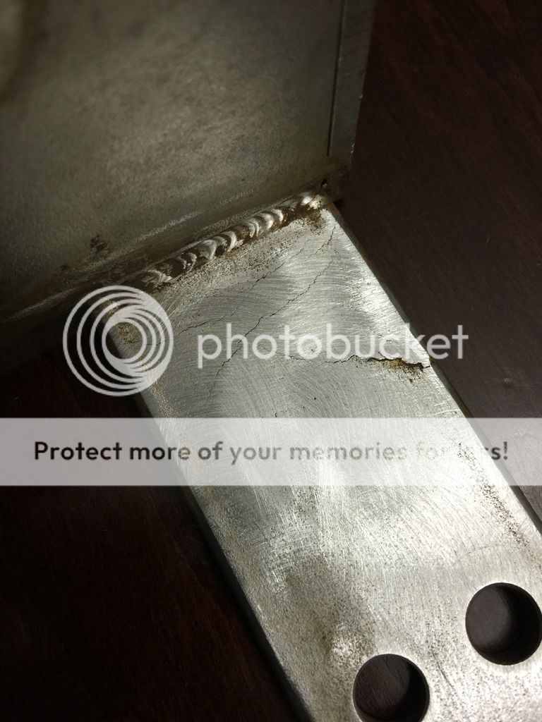

They look great Brad.
Just checking, after the work did you have them dipped (passivate the stainless to reduce the chance of rust)?
I have not yet. I am putting it back on for the weekend just to go sailing but I am going to pull them off and have it dipped along with all my stantions at the end of the season.

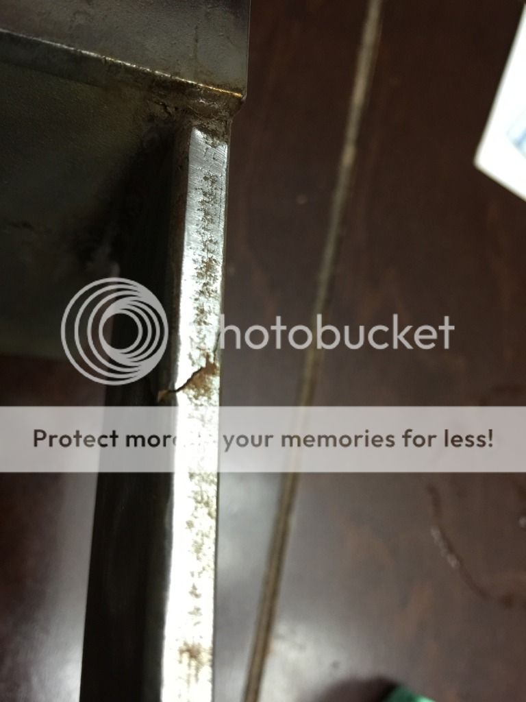

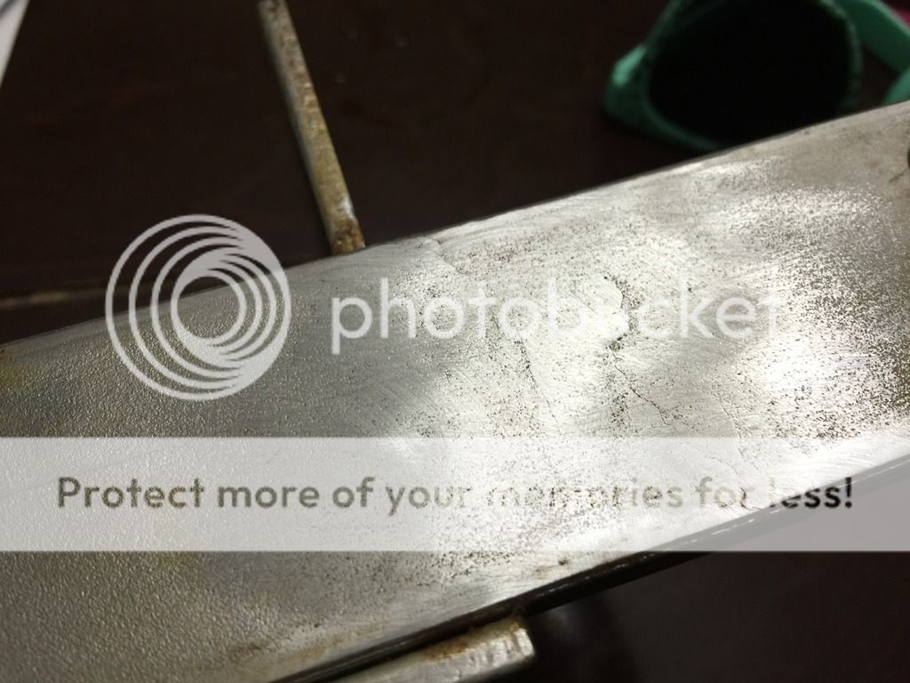

Beyond that.. I find this topic very interesting because 1 I am not sure those cracks can be associated with rust.. I think its just a failing chainplate - SO.. yes great idea to check them. But it also does show how much more abuse a saltwater environment puts on a boat. Here in S. Ontario we had more boats built in the 70-80s than any other area (save maybe CA) and most of those boats are still sailing with few if any critical failures, on original rigging and fittings.. yes we suffer the same core deck issues with water.. but the hidden damage from rust is almost no issue at all up here.
So when buying.. make sure you know the history of your boat.. where its been will give you a great idea of how diligent you may need to be. Glad everyone was ok.. hate sailing horror stories.

Omg! I wonder if the metal was subpar to begin with? Strange thing is so many cracks, you woulf think stress would flex at the large crack until failure.
