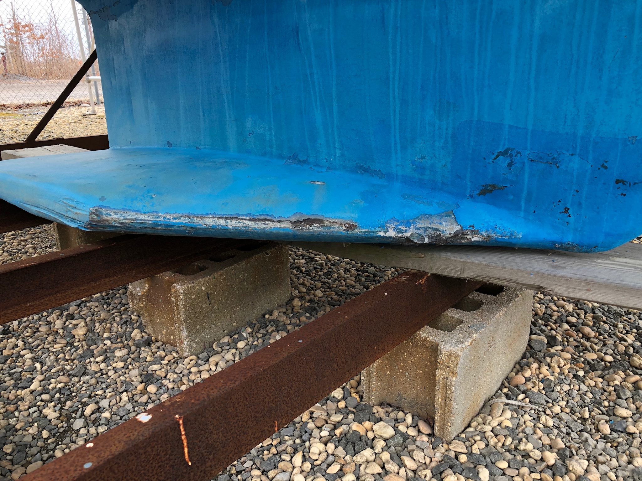

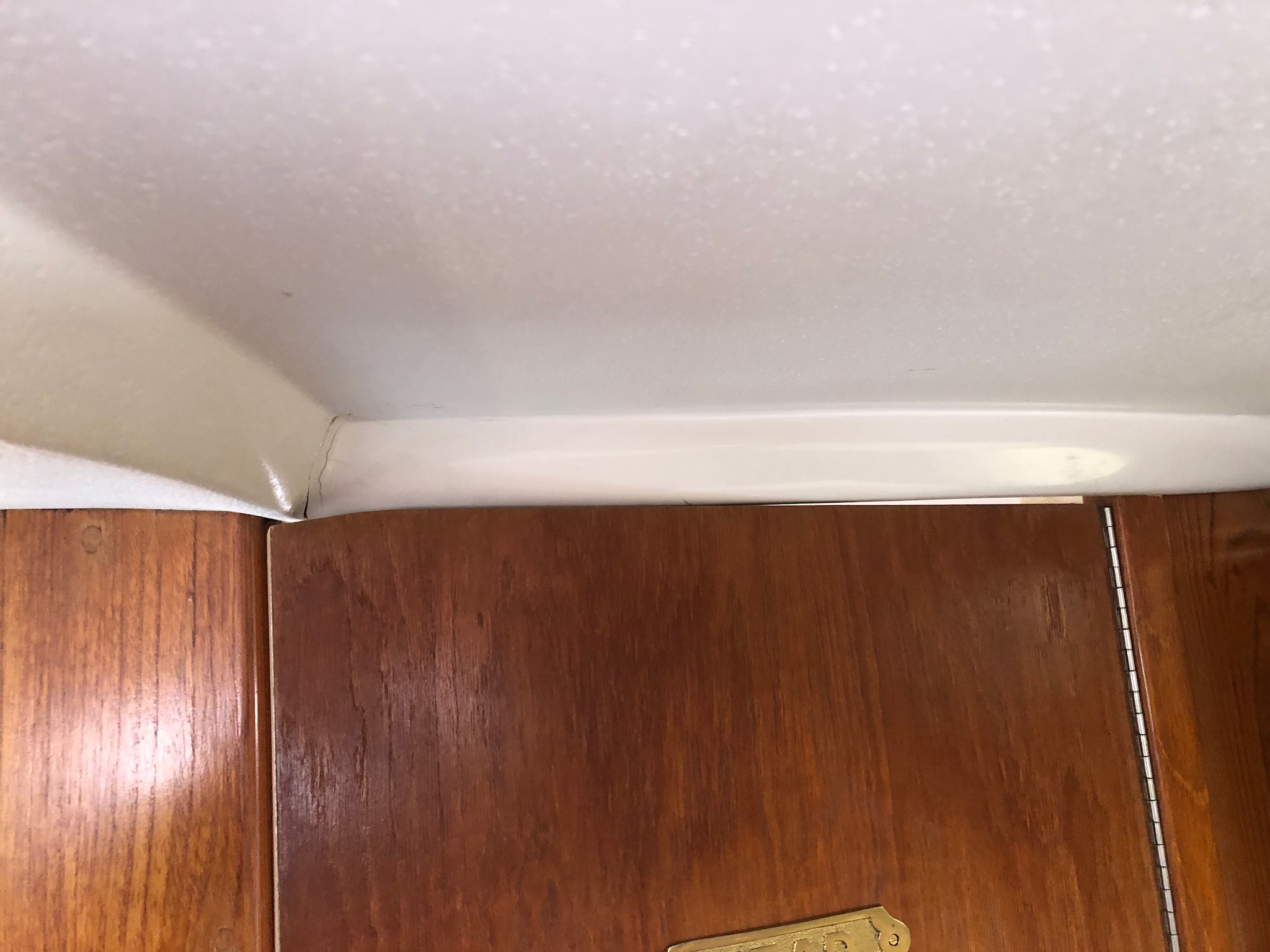

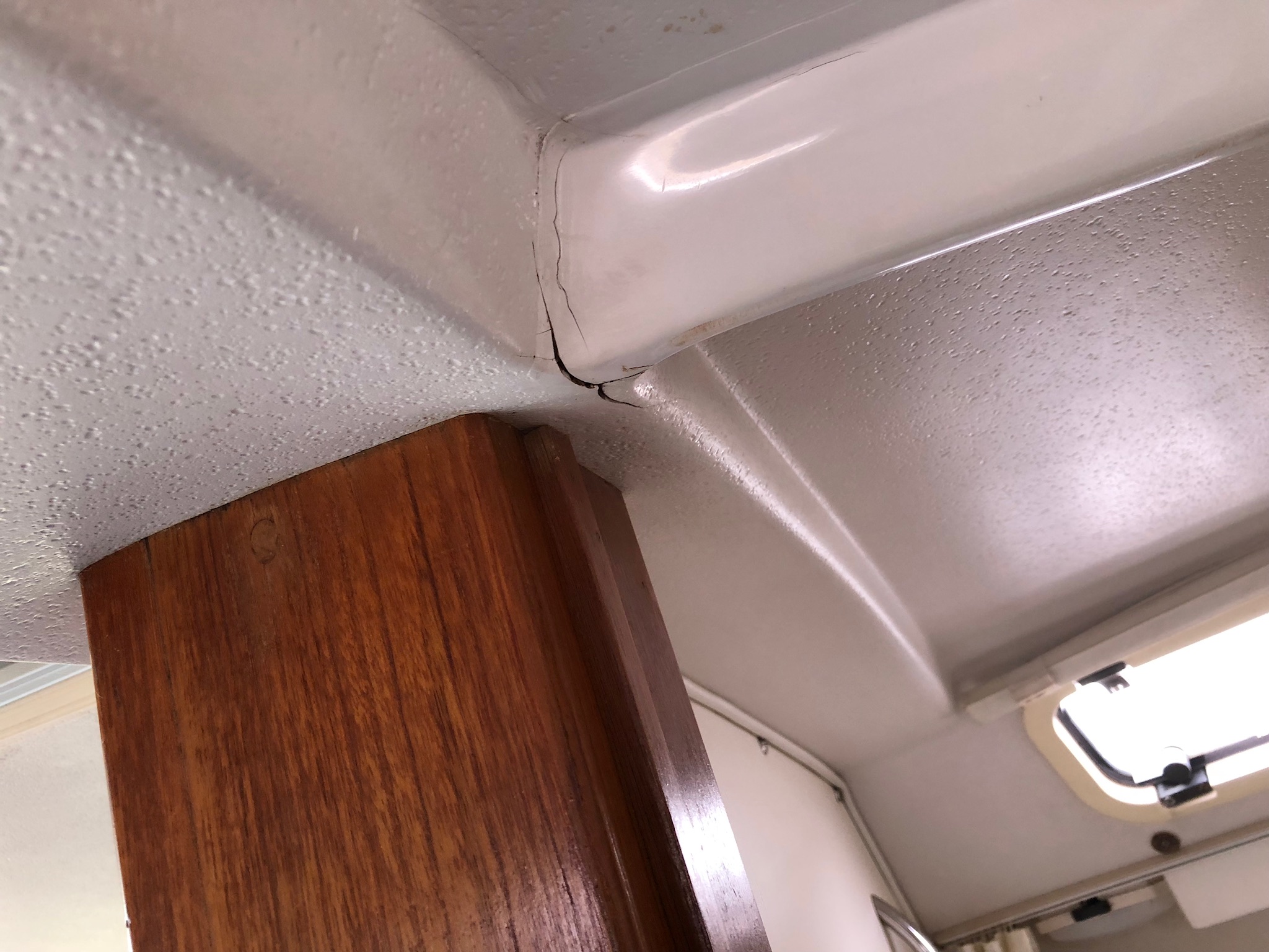

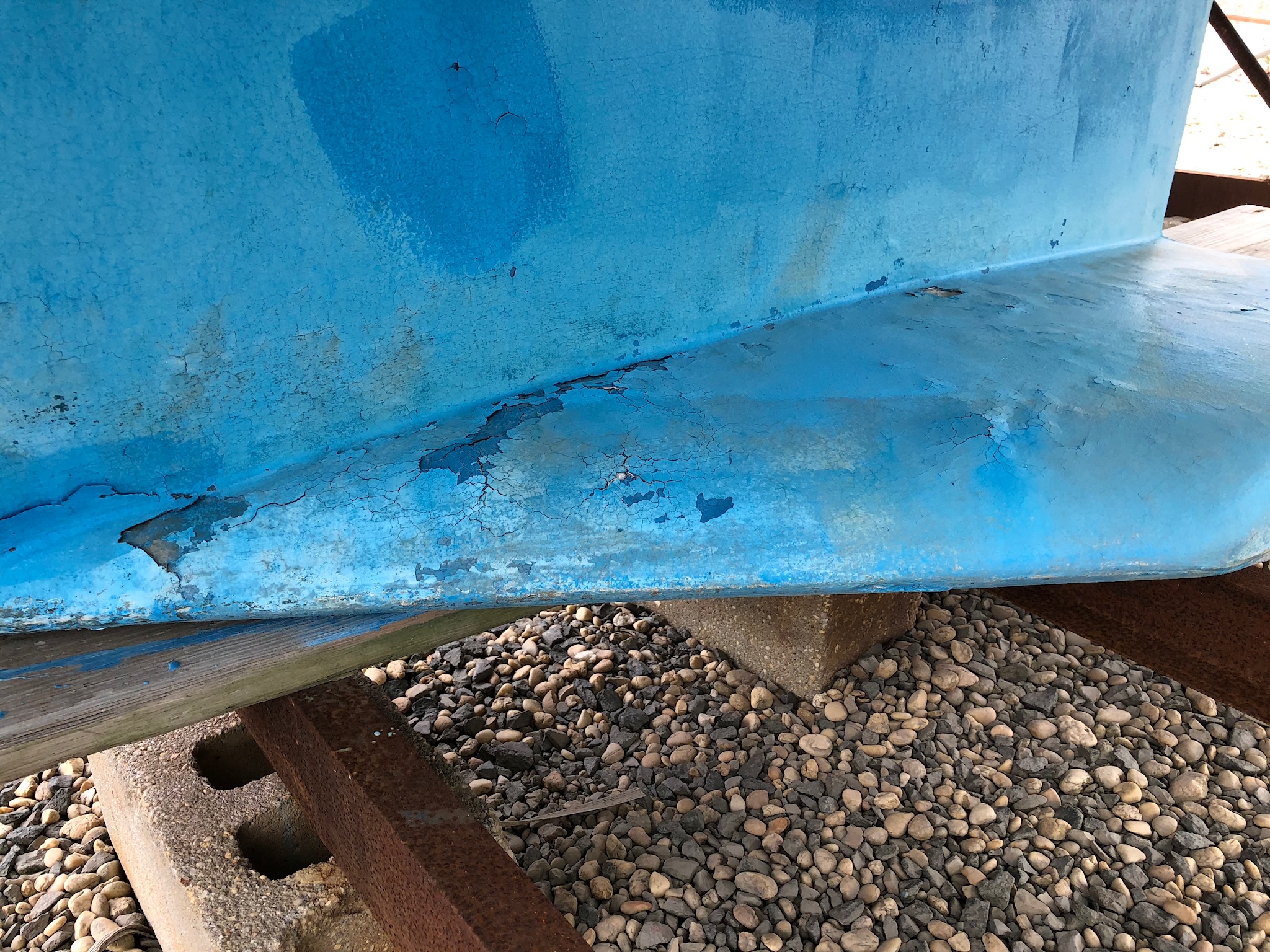

Ok. So I decided to move vet past this boat and keep looking. But to complete the info I got photos of the head liner crack and the keel. You can see the crack where the mast support passes through the headliner and how the door hits the overhead. Also, a added photos of the keel. Grounding damage on the one wing and blisters on the other.

You made the right decision. :thumbup:
