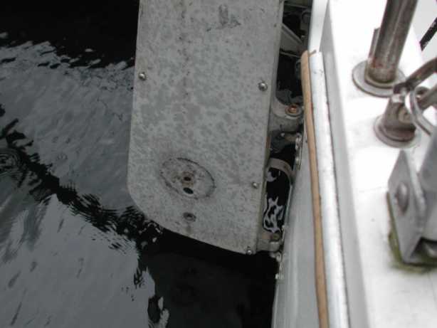

The bolts that hold (held) the lower half of my rudder to the upper half broke and the lower piece sank into the wild blue. Has anyone fabricated a piece for this? I'm thinking of making one out of wood. Any suggestions on material/dimensions would be greatly appreciated. Mike

Does anyone know about how far below the waterline the rudder needs to go? It did happen while I was under sail with about a 10 knot wind. The boat was totally out of control. I was able to lower the main and jib fairly quickly and motored back using the throttle to steer (not an easy task) Here is a photo of what is left.
