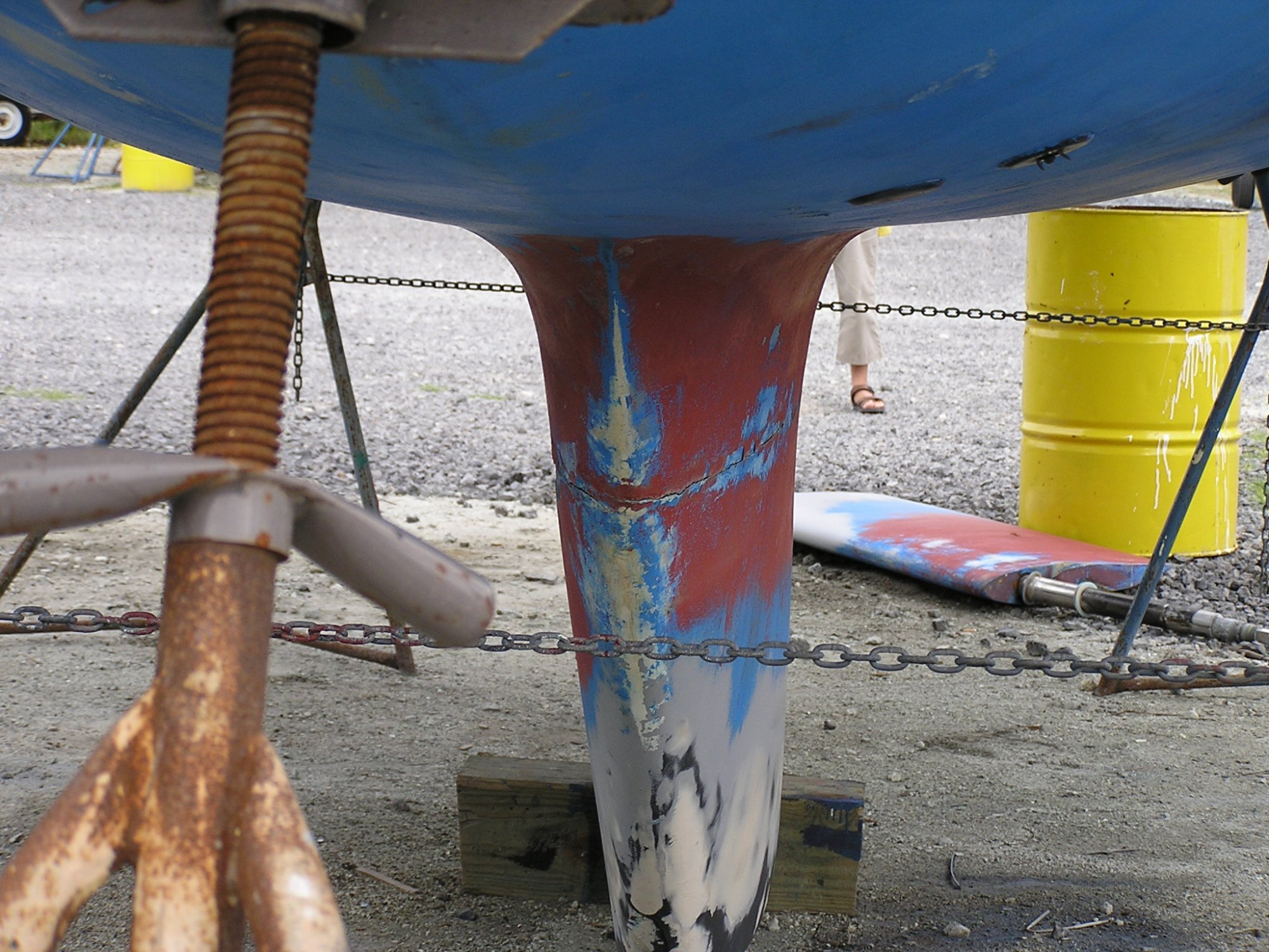

Congratulations... fantastic boat! Sailed to Europe & back through the Caribbean and Bermuda. Extremely solid took an extreme grounding before the Europe trip and can stand on it's keel.
