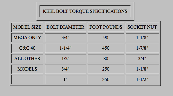

I am reimbursing a 1984 C&C 35'. We believe the current centerboard cable is broken and will replace when hauled out in March 2018. Does anyone know what the torque values are for 1" and .75" O.D. keel studs. Does anyone know how long the centerboard cable needs to be? Thanks.

This is from the "Technical" section of the cncphotoalbum.com site
