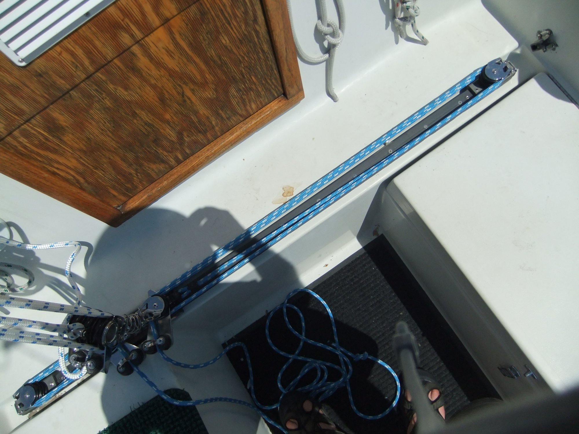

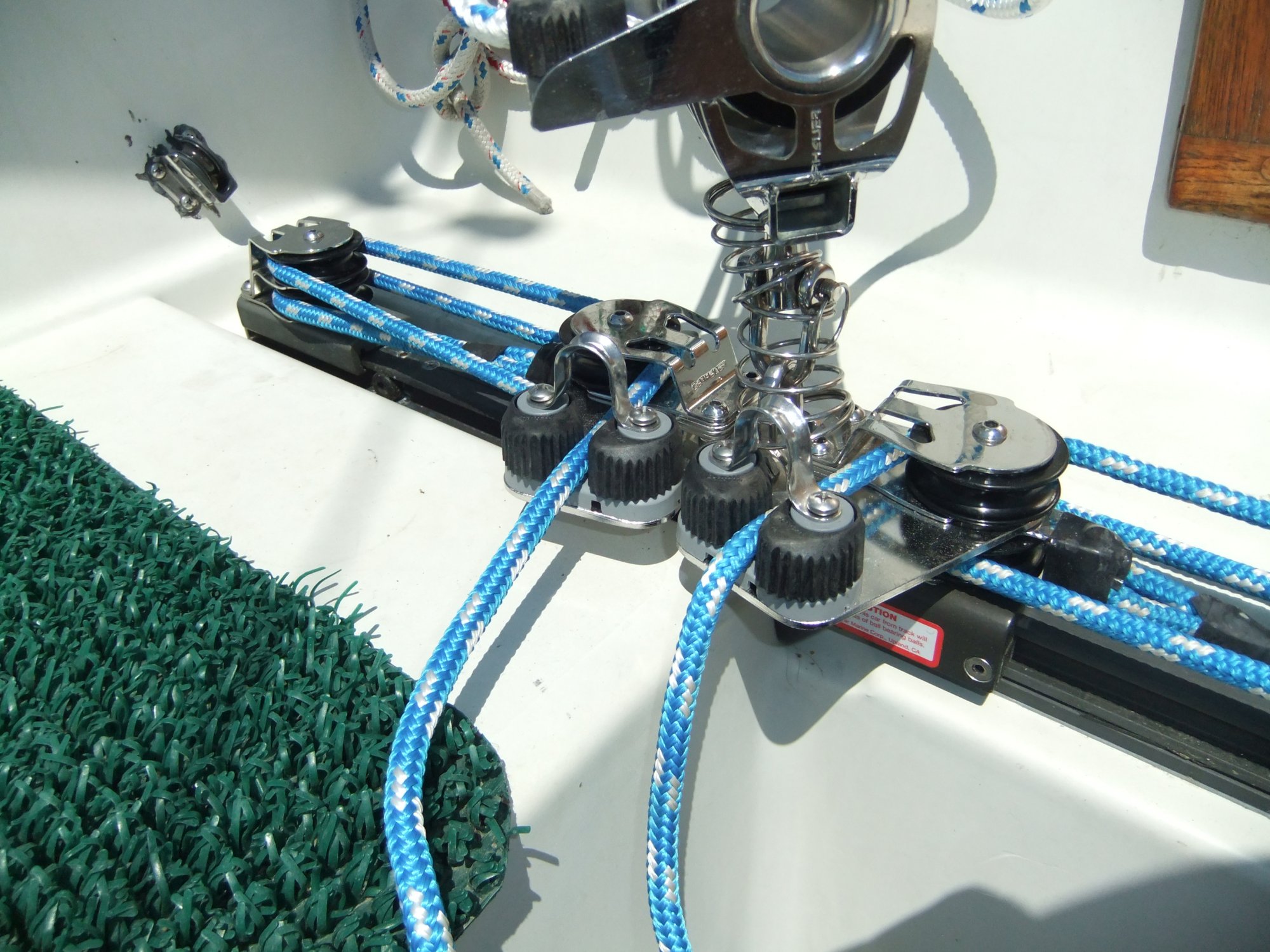

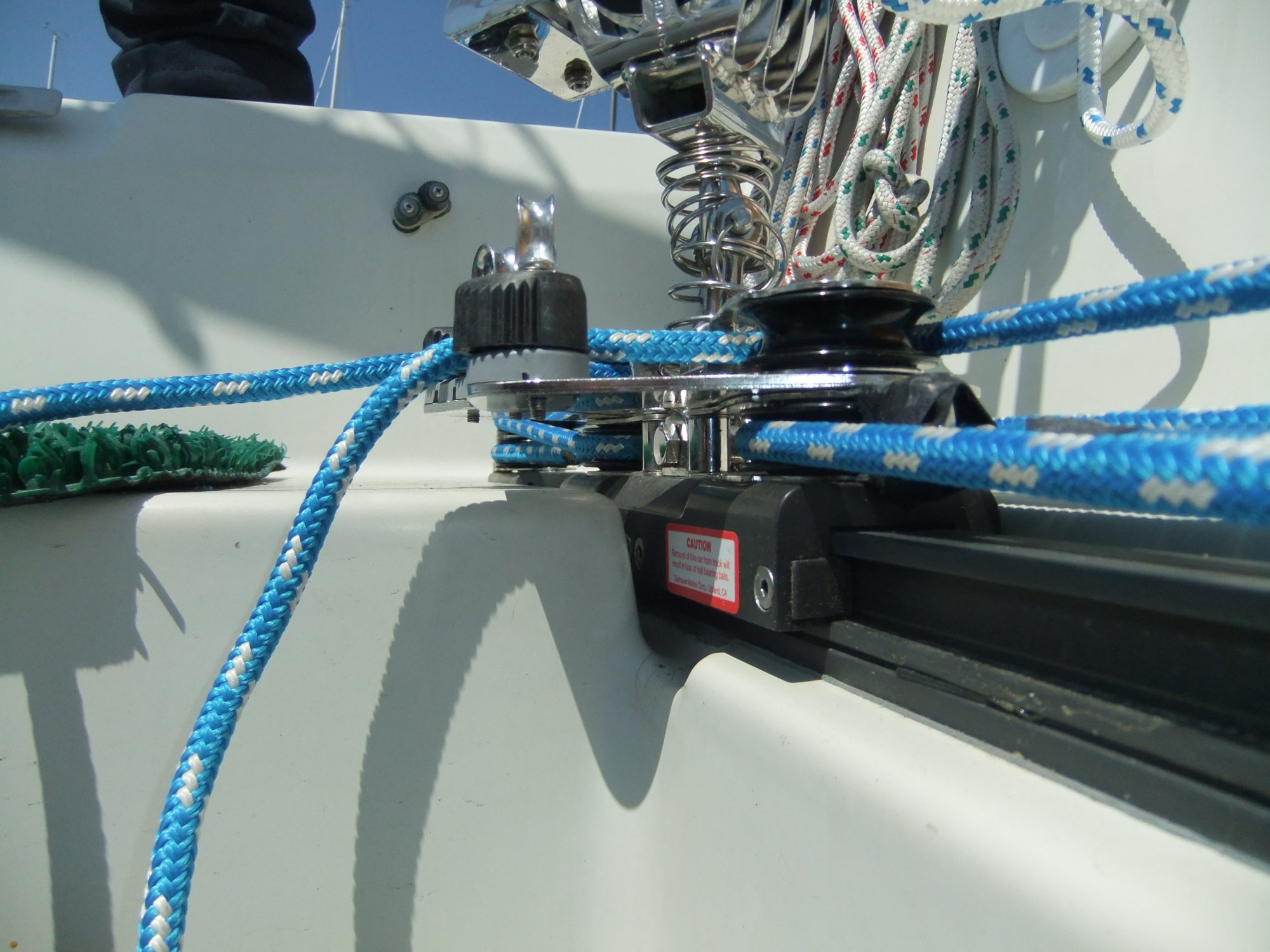

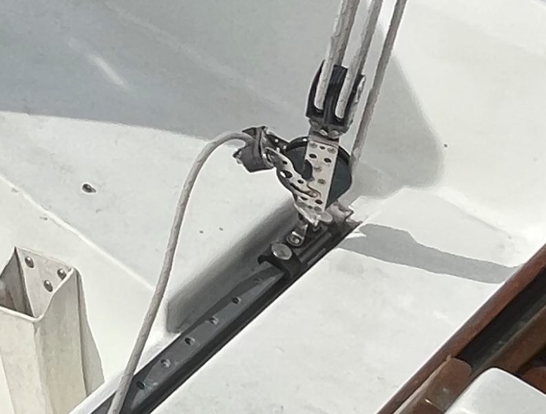

I just got my boat over the summer and have been scoping out upgrades. I currently have a 1” Schaefer traveler that uses the pin stops… Im doing a lot of single handing, so practically that means the traveler stays centered.
I want to upgrade to a 4:1 with cleats at the end of the rails. Has anyone done this kind of upgrade and have any advice?
I’ve already talk to Garhauer and their car won’t fit into the pocket the rail sits in without some sort of interface plate…I imagine other folks running into similar issues with other brands. Advice/prior experiences are appreciated!
