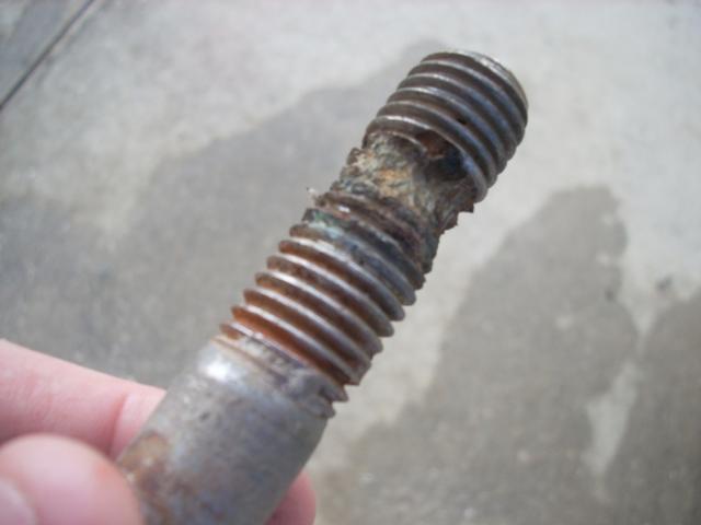

If there is a single thing that'll make life easier in reassembly it'd be a 16" piece of all thread rod the same size as the main bolt (3/4"?) screwed into the CB bracket to guide it back to the hole inside. Lastly putty it all up with compound of your choice being careful that overflow won't foul the line and pull/push it up into place. Cover the bolt head in sealant after it's well tightened.

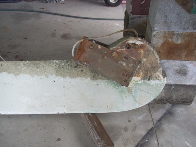

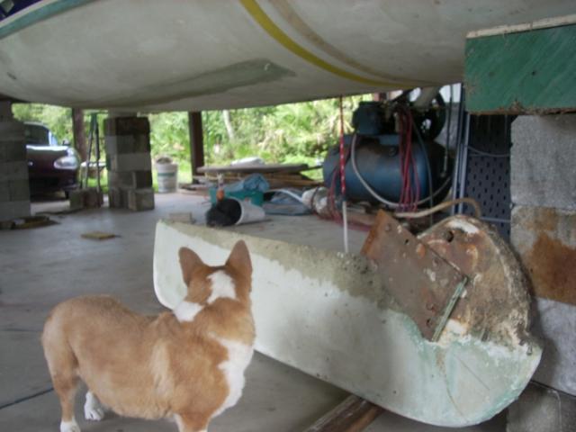

A few pics of our experience including the shocking condition of the main mounting bolt that was only 6yrs old.
