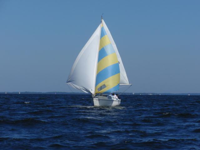

The Harken one is very expensive, approximately twice as expensive as the Schaefer. My son says that his Harken furler works great. It came with his boat. His has two grooves in the foil, which he used while sailing on our summer cruise on the Chesapeake, (see the attached photo). The Schaefer one only has a single groove in the foil, which comes in two pieces. We saw the CDI furler at the Annapolis Boat Show this past fall. The salesman said that one of it's best features was that you can't reduce tension on the luff of the sail. This certainly did not sound like an advantage to us. If you can't reduce the tension on the sail when you aren't sailing, you are destroying the shape of your sail. We told this to the salesman, and he replied that maybe this furler wasn't the right one for us.

I have a CDI furler that I installed on my sailboat and I think it works just fine. It is a low end product but then you will not be taking the sailboat into an ocean. I do not reduce the tension on the luff of my jib and I have never heard that this is beneficial or damaging to the jib. The purpose of a double groove on the luff is so that you can exchange the jib while on the way. Unless you are racing I do not see why pay for this additional feature. I hope this helps
