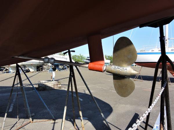

Which model Volvo Penta? I have a MD2030 in my boat and it has plenty of power for its size and displacement. It is not a raw water cooled engine. It runs very smooth but the saildrive may contribute to that. I see that the boat you are looking at has a prop shaft and strut. You should move those two zincs closer to the strut, about an inch forward of it would be better. No known issues to my knowledge with these engines. As with all engines, proper care by previous owners makes them last for lots of years. I don't think that a one time oil analysis will tell you very much.

How did survey go? The Max prop in the photo looks to have some pretty bad pitting in housing? Or is it just the photo, hard to tell. I just replaced mine this year, my blades were pitted and word beyond repair.

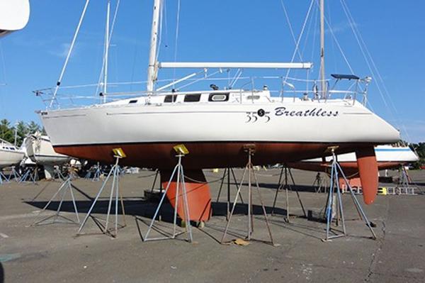

ive come back to oogling over the 35s5 so many times. Breathless is probably the nicest example. congrats on moving forward in the process of buying her.
