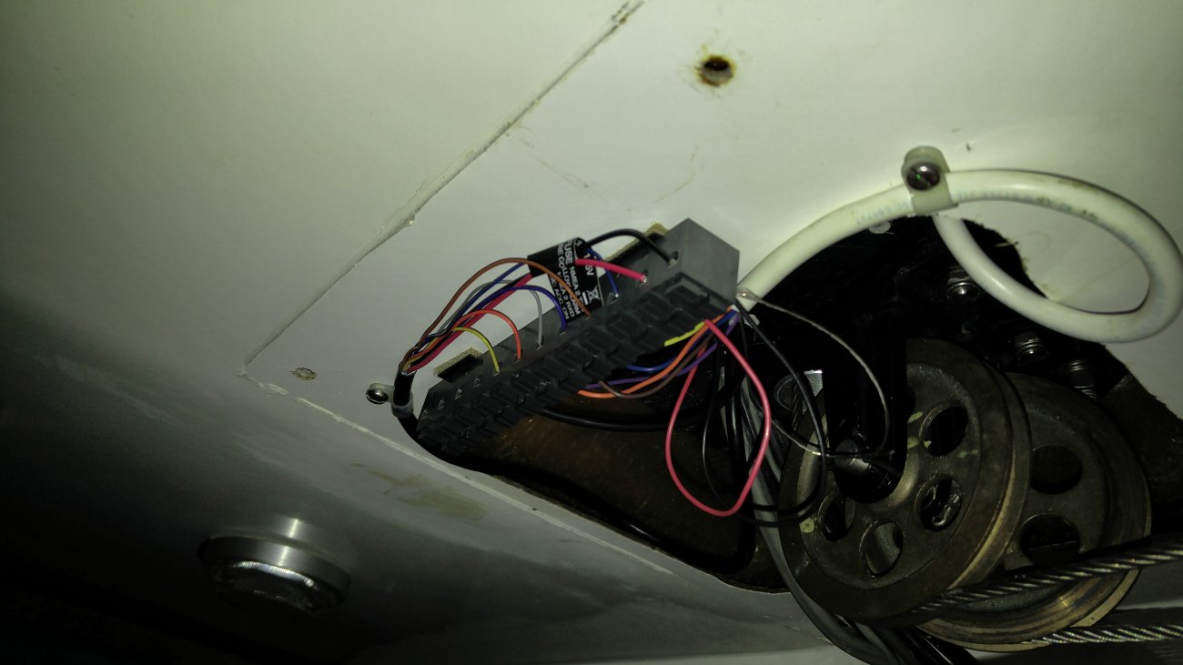

I don't know if this will help you, but I used NEMA0183 to connect my Raymarine Autopilot, B&G VHF/AIS, Garmin GPSMap 547xs and a laptop running Open CPN. I was able to take advantage of the capability of the 0183 interface where one device could talk, but more than one could listen. As an example, my GPS at the helm was connected to my VHF for position information, but split off to the autopilot. I see position on the VHF display and the autopilot will maintain a course set on the GPS. The AIS data comes out of the VHF back to the GPS so I can see the ships and branches to a USB connector where I can see the same information when running Open CPN. I used some terminal strips just to keep the wires organized and my schematic indicates the function as the wire colors had to keep changing. One strip is under the steering pedistal above the rear berth and the other end is behind the circuit breaker panel. The hard part was snaking wires through the boat. See the attached .pdf file and photo of one terminal block.

Thanks for the schematic. I'm beginning now to understand both the advantages and limits of 0183 interconnections. For the time being though, I think I'm going to keep things simple. Major planned project for next season is a full AIS system. Then would be the time to sort this all out.
