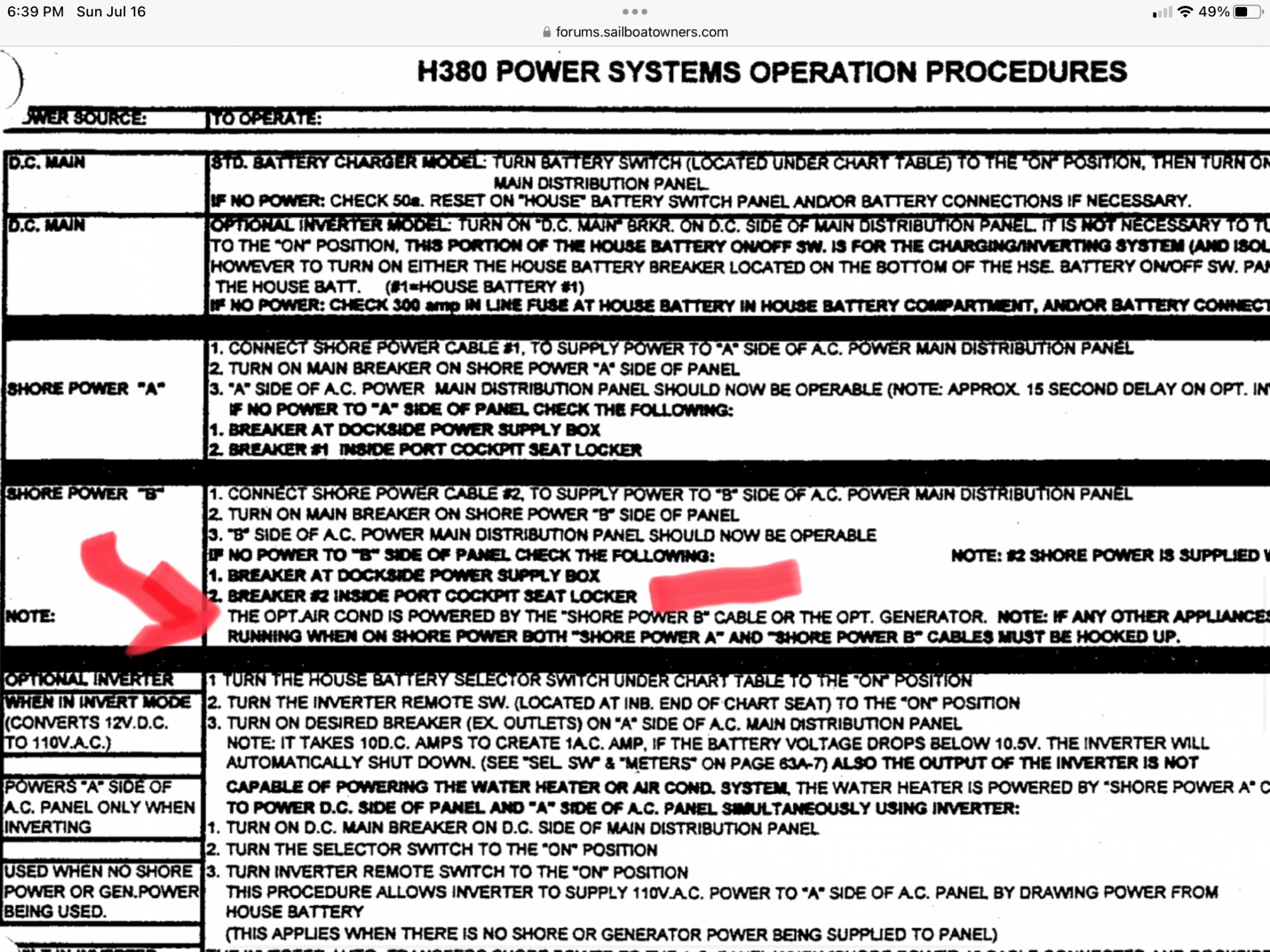

Where do I find the schematics for the electrical panel used by the H380?
All was well then I lost the "AIR COND / POWER" BUS B indicators and no AC. The "SHORE POWER A" is working fine. I plugged to another slip - same results?

Can’t help with the schematics, but I would first check for the presence of a breaker of some sort near where the shore power inlet is mounted in the boat. I would expect there are 2 since you probably have 2 shore power plugs. One for the AC could have tripped. It is usually close to where the power cord plug is.
Did you notice anything that may have tripped a breaker? Were you running the AC at the time?

Yep….this is where I would be looking…inside port cockpit locker…find the breaker.

Thank everyone, the problem was my fault. The H380 has a manual transfer control and I did not notice that it had gotten switched, problem solved, again Thank you all.
