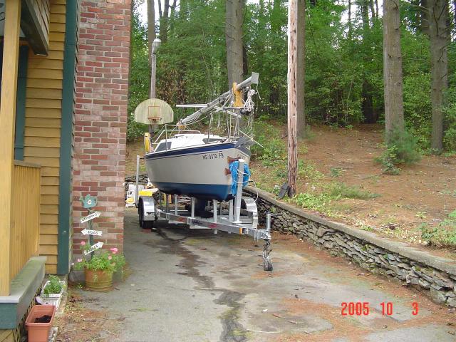

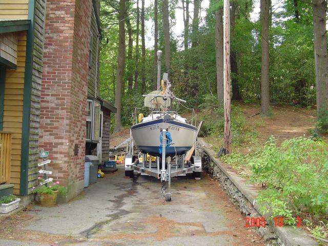

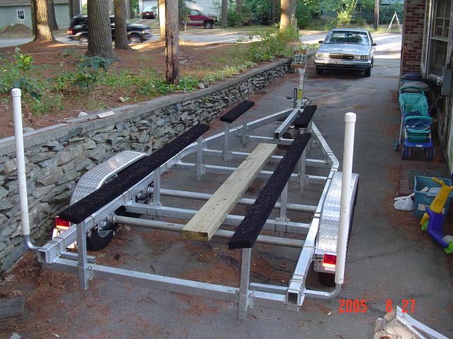

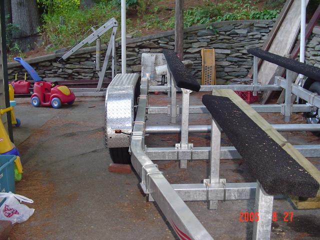

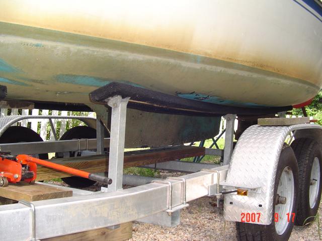

I fitted a 19' bowrider trailer having a trailer shop weld a length ( about 8" ") of square iron to where the bunk bolted origionaly bolted to the trailer and then they welded a a piece of angle iron about the same length to the trailer side and with the use of a square type u-bolt I had ajustable bunks by sliding the square stock into the angle iron and locking them in place with the u-bolts.
I puzzled out the rough measurments( 2 to 3") between the bottom of the keel would sit to where the bunks would meet the hull from pics of 23s on trailers using anything in the pic that would help to develop a scale ie 14 in tire rim.
I also used the spec on the boat from the I love odays web site which state 24" draft board up.
It wasnt cheap the trailer shop charged me almost 500.00 parts and labor.
The bunk for the keel had to be elevated about 4 inches from the trailer/frame cross members to allow for the axle/leaf spring moment. measure fr0om the bottom of the trailer to the top of the axel with no weight on the trailer for this distance.
I u-bolted short pieces of 4x4 to trailer cross members and then an 8' 2x10 for the keel bunk was lag bolted into the 4x4s.
the 2x10 is really not thick enough and in hind site I would have doubled this up 4x10 maybe 2by angle iron screw into the 4x10 lenght wise
As it turned out the center board was stuck 8" hanging out of the keel making the ajustable bunk a life saver.
I bought the boat hom to north west NJ from long island with ot a problem.
Ive also used the triler to pick up a simular boat for a friend the ajustable bunks are also removable by undoing the ubolt complelty which is pretty handy when taking boats off the trailer on land.
