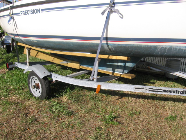

Thank you all for replies. Phil, thanks for suggestion and photo`s decided against plastic, I`ll explain in message. Thinking about Warton creek for next holiday weekend.
10,453
-na -NA Anywhere USA
Regarding the photos of the straps attached to the hull to deck joint at the rub rail, overtime, you will damage that lip and suggest to avoid doing that. I would put a strap over the cockpit and down to the trailer frame twisting the strap a couple of times to prevent slap. Never put a strap over the forward deck to the trailer as it can and will cause damage to the hull where sitting on the bunk boards. In addition to the winch strap, you should have a chain if your trailer is a Magic Tilt. if that chain is too long, twist it to shorten it. If no safety chain, then add one immediately for safety as I have seen boats come off the trailer when the wind strap has broken.
