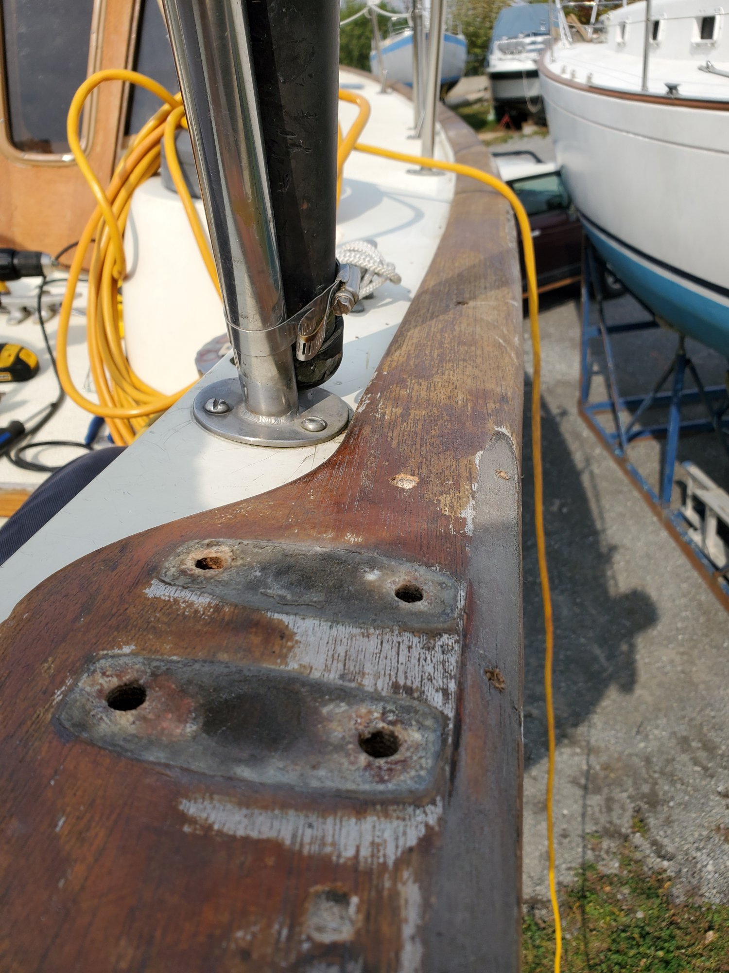

I have leaks along my toe rail. There is a very active owner's group for Islander Freeport 36s and it seems this is a common thing in these boats. There is very good information on how to open up the hull to deck joint, clean it out, and seal it back up. The first step is to remove the teak toe rail.
The problem is the bungs appear to have been glued in, could be epoxy. Does anyone have any advice removing bonded in bungs and then slot head screws filled with epoxy?
There are a LOT of them and at this rate I will be in for over 1000 hours just removing screws.
