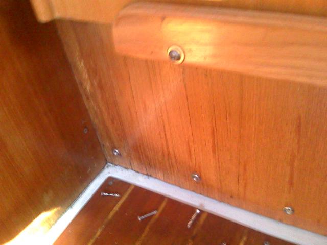

I was thinking of running machine screws through it and using a t-nut on the other end - plus 5200 or liquid nail. I know 5200 is not good in most uses since it is such a strong bonding agent, and it would make it very difficult to remove this bulkhead if it needed it again. But I'm figuring that if done right, and if the deck penetrations are kept sealed properly, then I'll never have to remove this bulkhead again.
Also, on the C36, this bulkhead is in 2 parts. The inside (towards the centerline of the boat) is the main, wide part to which the chain plate is attached. This is the part I'll be removing. Then there is a narrower part, maybe 2.5 feet wide, that goes all the way to the hull. There is nothing structural joining these two together - the joint is only covered by a little trim strip. What I'm thinking of doing here is fabricating a 1/4" stainless steel strap and bolting these two parts together with that. Then I'd route out the back of a piece of teak 1x3 and cover it with that.

if it were my boat...
...I'd glass the bulkhead and replace the standing rigging. I'd also inspect the chainplates very closely before deciding to re-use them.

chain plate
...I'd glass the bulkhead and replace the standing rigging. I'd also inspect the chainplates very closely before deciding to re-use them.]
What should I look for in inspecting the chain plate? Bear in mind, this boat is only eleven years old. (I've pretty much decided to go ahead and change the standing rigging.)

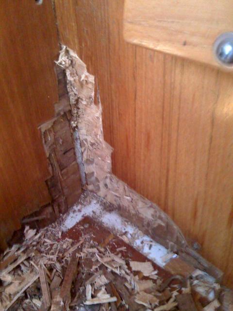

My Mirage 27 had rotten bulkheads due to 2 problems prior to my purchase and restoration. Improper bedding of the chain plates allowing water to enter and rot the chain plate attachment areas, and standing water that had entered the boat while in storage, rotting out the bottom of the bulkhead. Take a look at my web page, were I describe the project.
Jim
May 21, 2007
775
Catalina 36 MK II NJ
Most Catalina 36 will fail in the same fashion. I know, I have one.

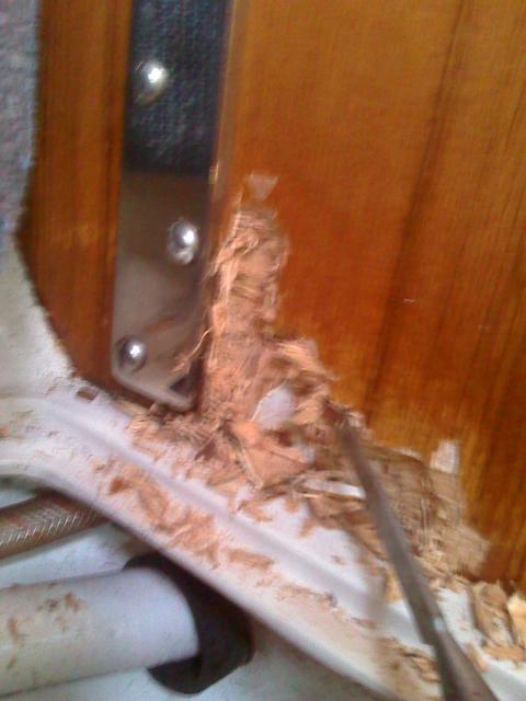

bulkhead repair
I own a 1985 26 foot oday with a starboard side leaking chainplate ,this ongoing problem an battle has compromised the integrity of the bulkhead. I have been advised at the yard that they can install a sheet fiberglass to remedy this problem and since it is glass they say that it will not happen again. I am uncertain as to the practicality of this as well as the cost. I do know that once the old is out it is just a matter of installing the new one whichever product I use.
I read here that a product called CPES can be used ,has anyone tried this tack? basicall I would be solidifying the bulkhead and possibly replacing it at another time.

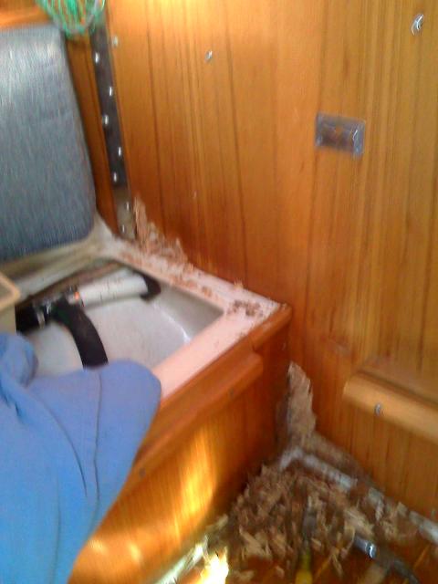

I used this product when I replaced the bulkhead on my C36. It is a filler/sealer and it seems to work very well for that purpose. I am not at all sure it would actually strengthen an already-dry rotted plywood bulkhead. As for fiberglass - I don't know that it has the structural strength, although there is a synthetic product - I forget what it is - that can be used in place of plywood, supposedly.
Having replaced the bulkhead on my C 36, I think that if the integrity of the bulkhead is compromised, that it definitely should be replaced. I can't see that this would be any more difficult than it was in the case of our boat, since the mast had to be pulled for mine.
Yakman, if you go to the C36ia web site, look under "upgrades" in "articles" you will see what it involved for our boat. My opinion, which is far from an expert one, is that if it is compromised, replace it using a sheet of marine grade plywood and replace it, using a filler/sealer like CPES first.

Not for Catalina
What mainesail said about having catalina send you one that is cnc would make instalation much easier I would guess. A cnc cut bulkhead will make a professional looking repair easier since you won't have any gaps around the edges. Since they don't stock it, another option would be to ask for the 2D cad file. You can take that to a shop with a CNC router and they will knock it out for a couple of hundred dollars, probably in a day or two. A waterjet will also do the cutting if they know what they are doing. If not they will delaminate the plywood and end up buying you more.
It's probably an autocad file and if it is the file will most likely be a .dwg or .dxf. .dxf seems to be more easily transfered to older machines. Ask them to send you both if you go that route.
We are not talking about a Catalina at this point, since my job has been finished. Catalina doesn't stock these bulkheads and had no suggestions as to how they could help with that. However, it was a simple matter to simply use the old one as a pattern, using a router with the appropriate bit as shown in my explanation on the C 36 web site.
I don't know about the ODay; maybe they do stock this bulkhead. It sounds to me that having a shop make up the bulkhead might be pretty expensive, but if you aren't set up in any way to do it yourself, maybe there would be no alternative.
Yakman - if you have any questions and want to ask more about my experience, please feel free to ask more either on or off list.
