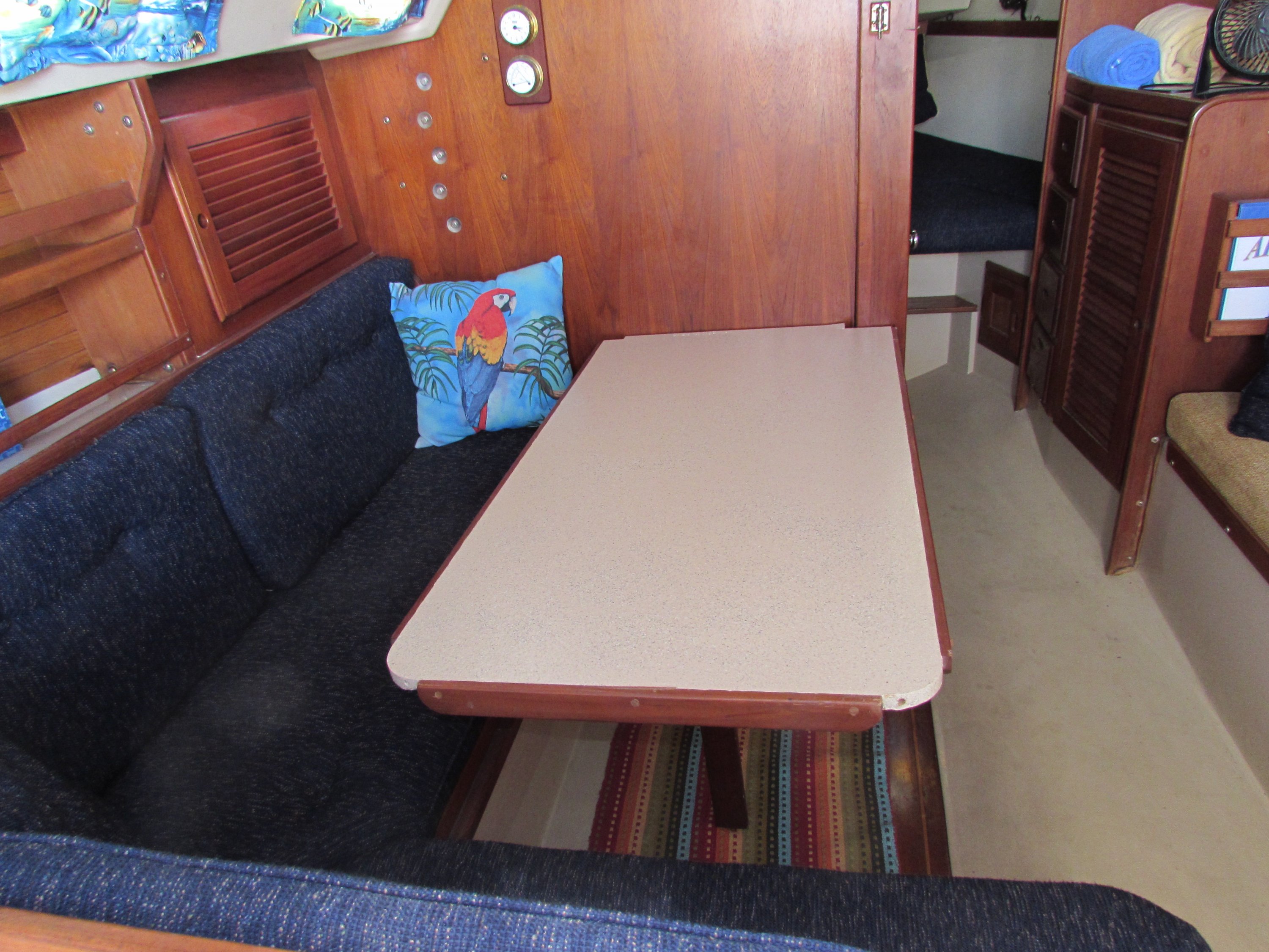

I have a 1988 Catalina 30 that was surveyed in December 2016. There was no problem with the bulkhead at that time. Now, there is a gap between the port bulkhead and the compression post. It starts about half way down the post and widens as it goes towards the salon floor. It is about 3/4" wide at the bottom. Any idea of the cause and the cure? There have not been and recent rigging changes that I'm aware of. The bulkhead in the picture was in December, no gap showing.
