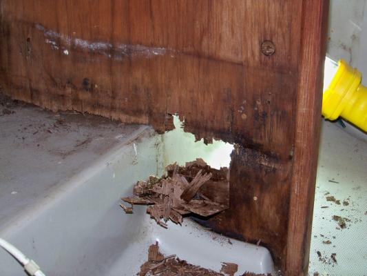

Has anyone had experience in replacing the aft starboard Bulkhead on an Oday 25? The upper right corner has rotted out due to water seeping in through the shroud attachment

Is it easy to remove? I take it it that it is attached through the sink cabinet? Is it secured anywhere else to the hell or deck?

It's not a big deal, but neither is it like replacing a doorknob. The bulkhead is usually glued to the hull via tabs, which can be cut with a angle grinder ir hammer and wood chisel....carefully. The cabinetry is usually only screwed together so is not to hard to tske apart. You will need to start taking things apart and see what u get into.. Also, where there is bulkhead rot there is other problems you have yet to find. Most glaringly, why is the bulkhead getting wet and repeatedly over a long period? Are you a do it yourselfer?
Also there is the option of using git rot on the corner and it will harden and stop the rot, but is unsightly. Not a prob if the area is hidden from site, yet open enough thet it can be fully accessible with a brush, and completely dry.

Look up my posts from last summer to see some of what you might run into. First of all DO NOT SAIL until fixed. The chainplate is likely to pull out under load, shoot through the deck and take the mast over the side (like mine did). Choose only marine grade plywood for replacement. The bulkhead is screwed to the settee and to the cabin liner in addition to being fiberglassed to the hull. You want to get it out in one piece so you can use it for an exact template. You will need to take out the compression post to be able to slide the bulkhead out. Unfortunately the leaking has also damaged the balsa core of the deck so you will need to remove a section of deck to get ALL the wet core out then replace the core and reglass the deck. As has been said previously it is not impossible but will take time and you'll swear a lot. My yard wanted several thousand to do the replacement (I did both sides while I had things apart), I did it for about $500 in materials. (You'll need 2 4x8 sheets of marine grade plywood to do both sides, I used Meranti)...google it and you will find a source, I sourced mine in NJ.

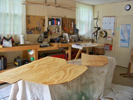

To save some money, maybe, you might be able to do it with one sheet. As mentioned above you can't get both bulkheads out of one 4x8 sheet of ply. Almost but not quite.
If the port bulkhead, which is bigger, isn't in too bad shape the starboard bulkhead should be small enough to be cut out of the old port bulkhead.

What Keith and Rich have not told you is their pages in the archives about this project. And then there is Appleman's project and pictures somewhere in the archives and who was the guy before him, Joe something?
This is a doable project should keep you busy. Find the several threads in the achives for reference.
