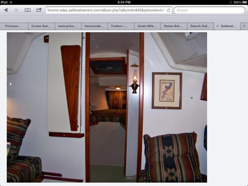

faustkaren said:
My next question...
What is the veneer on the original bulkheads??? I am willing to spring for Teak.
I painted mine with lowes porch paint. It sets off the teak trim nicely, and was way cheaper than teak. Plumps I was able to buy local.
Sep 4, 2012
22
ODay 26 Lake George
My bulkheads are 1/2" and the compression post is 3 1/2"x 1 1/4"
I am pretty sure mine are 1/2" too. I talked to Rudy at D&R he believes that they are veneered in Teak. Paint would never go over with the Admiral. The galley and saloon are all hers. I just maintain them. I may go with 3/4" plywood because you have to grind off the veneer so the epoxy and glass have something to really stick to.
