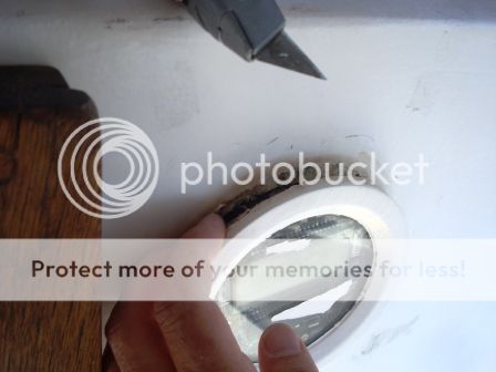

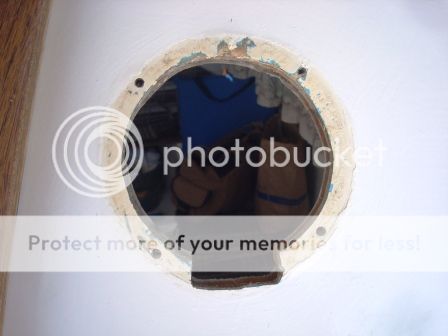

When I bought the boat, there was an old inoperable depth gauge in the bulkhead. In fact, it looked like the glass face had been painted over at one point.
Anyway, it had to go. 4.5 inches of ugly. So today I took my knife and cut around the bezel.
A bead of silicone and some paint were all that held it in place.

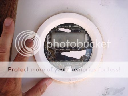

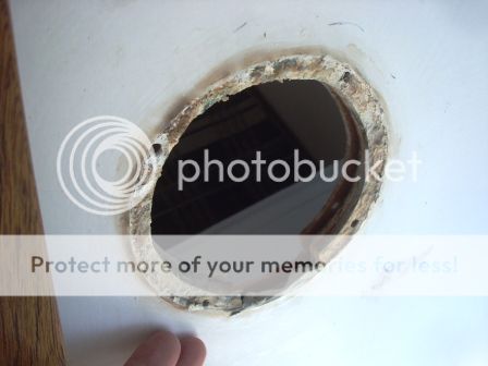

Now to scrape it clean with my putty knife.
Looks like that round gauge wasn't the first inhabitant of this hole.

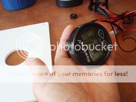

Cut some marine board, and put in a 2 inch hole and some counter-sunk screw holes.
Learned the hard way that black electrical tape leaves nasty marks on the paint! Blue tape to the rescue.
Bedded with some white marine sealant and screwed into the bulkhead.
Handy new depth gauge. For now, it'll pretty up the panel, but wiring it up and installing the transponder will be a project for another 106 deg Arizona day!

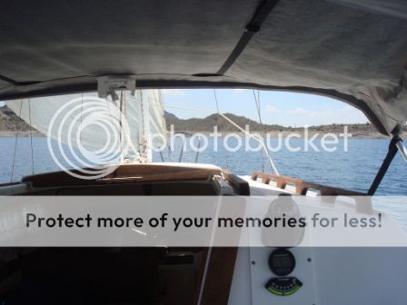

Handy information center. I positioned everything so that you can still lean your back against the bulkhead and nap when someone else is sailing.

What about magnetic interference ?
I'll know more once I get the depth finder fired up. The magnets in the compass are very sensitive to metal in close proximity. But the df has very little mass of metal in it... mostly plastic, and no windings which would amplify electromagnetism. As a test, I could not see any deflection when next to the much larger old unit I took out, and none from the new unit, but we'll see once electrons are flowing.
Stan

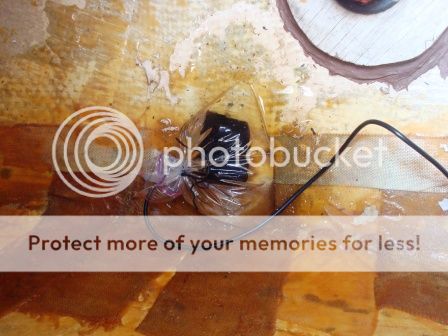

I'm placing it in front of the keel in the center of the hull through the v-berth hatch:
The transponder cable ran up the starboard bilge area to the bow area, "no problemo." First, I did the plastic bag filled with water routine...
Bang... got a reading right away, but it seemed a bit high...
I'm sitting at the dock at the launch. 18.5 seems a little deep... so just for grins, I tossed out the baggie, just set the transponder on the hull and poured some water in there around it...
Bingo! It worked like a charm all day just laying there!

G'day Stan. Nice job on the instrallation and testing. After I installed my new depth gauge and in-hull transducer, I verified the depth at the slip and at anchor by the old method of a sounding line - tie a weight to a length of line and tie a knot every foot (say 20ft depending on where you're at), then toss the wighted end over the side with the boat at rest. Measure the depth against the displayed value. Some units can be programmed for an offset if you want depth under hull or depth under keel. Not sure if that's important but the real world test is a good soother of the worried mind.

No detectable drift on the compass due to the DF. In fact, you can see by the mount it is out and up from the DF anyway. Had a nice 3-hour sail today...
Yup, N S E W were all about where they should be! This old Catalina 22 really groans and creaks when you get her heeled over 15 deg or so in the gusts.
