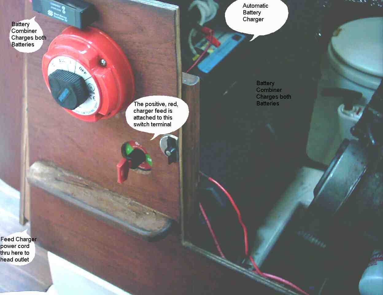

This is a picture of my set up. It has evolved over the year and is likely more complex than it needs to be. From reading posts here every boater has his own solution to the battery storage problem. The engine compartment was extended to hold group 27 batteries. Likely four batteries could be stored in this space. A combiner was added to enable charging both batteries safely. Also, a switch to connect the alternator directly to the batteries was added bypassing the "outflow" switch between the starter and house batteries. This, of course, is not needed but may prevent accidental disconnection of the alternator while running.
