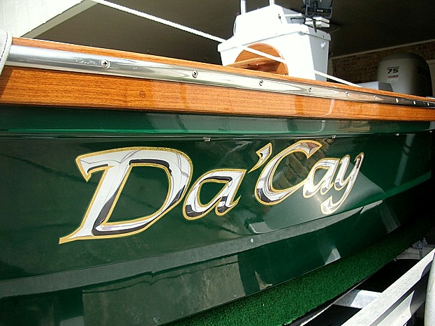

Actually quite simple but I've taken the time to explain all the steps to get a hull looking as new or better than new for a complete beginner.
These are the results of folks who had no previous experience..

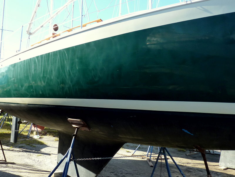

The "overly complex" detail is there to hopefully prevent beginners from doing things like this:
just get some "polish" compound, not rubbing compound,
Some boats may need a heavier compound or even wet sanding.. Polish alone simply will not cut if the hull is already beyond a polish.
