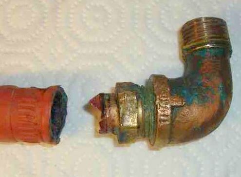

They can be ordered from any Groco dealer and the issue is NOT price. Cut a corner and mix brass and bronze and it could cost you a lot more than the price of a nipple!!:doh:;)
This is what can happen when mixing a brass hose barb and a bronze elbow. Note the pinkish dezincification of the brass where it broke..

Hose barbs on plastic or rubber hose isn't the problem. It is when metal-to-metal contact is present, like using a copper or brass pipe nipple with a bronze fitting. The fact that the two metals are in contact and one is more or less noble than the other is what causes the problem—especially if the fluid they're carrying is salt water.
Here are two identical hose barbs. I cleaned one up and left one how it came out.
